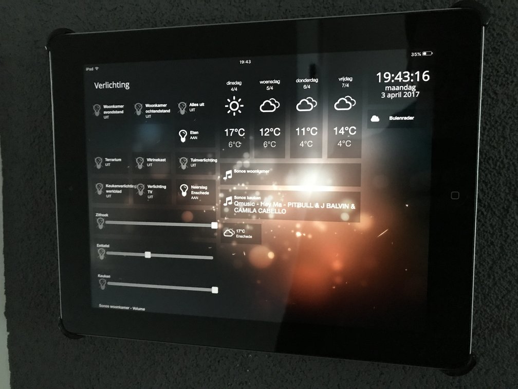

Your dashboard is really awesome! Today I mounted an iPad to the wall to show all those cool things.
I have some devices that I would like to add (like the usage of my 'city heating' ). Here is the JSON-output:

And what is the easiest way to add a shortcut to Domoticz in the dashboard?
I'm also not able to switch scenes (I don't use groups). I mentioned that before:
Dynamic wrote:How can I activate a scene? My 'favorite' scenes are visible, but when I click them, nothing happens. Or is it designed for groups only?
Edit: I found something. When you activate a scene/group, it does:
/json.htm?type=command&param=switchlight&idx=1&switchcmd=On&level=0&passcode=
But it should be:
/json.htm?type=command&param=switchscene&idx=1&switchcmd=On&passcode=
How can I fix this?
Edit 2: got it. In main.js you have to change this line:
else if(data.result[r]['Type']=='Group'){
info:
else if(data.result[r]['Type']=='Scene'){
I will buy you a beer!

HansieNL wrote:@Dynamic:
What did you use to fix it to the wall?
A very cheap wall mount, just 13,99 euro!
https://go.bol.com/p/9000000012512507
