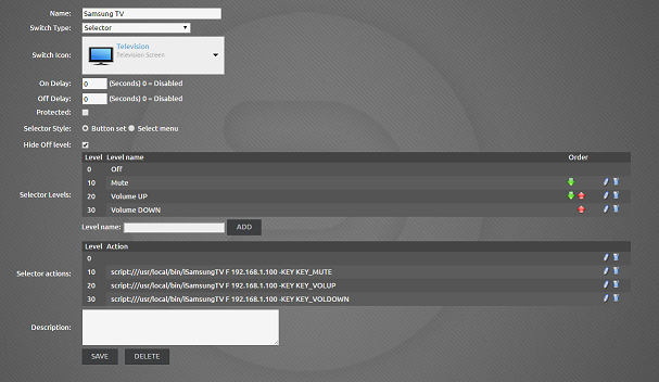

Finally made a button to control my TV in domoticz, but seems its not working well ..
2017-04-18 17:31:47.268 Error: Error executing script command (/usr/local/bin/iSamsungTV). returned: 512
This is what im getting to log in domoticz, from command line its working well .. ?
