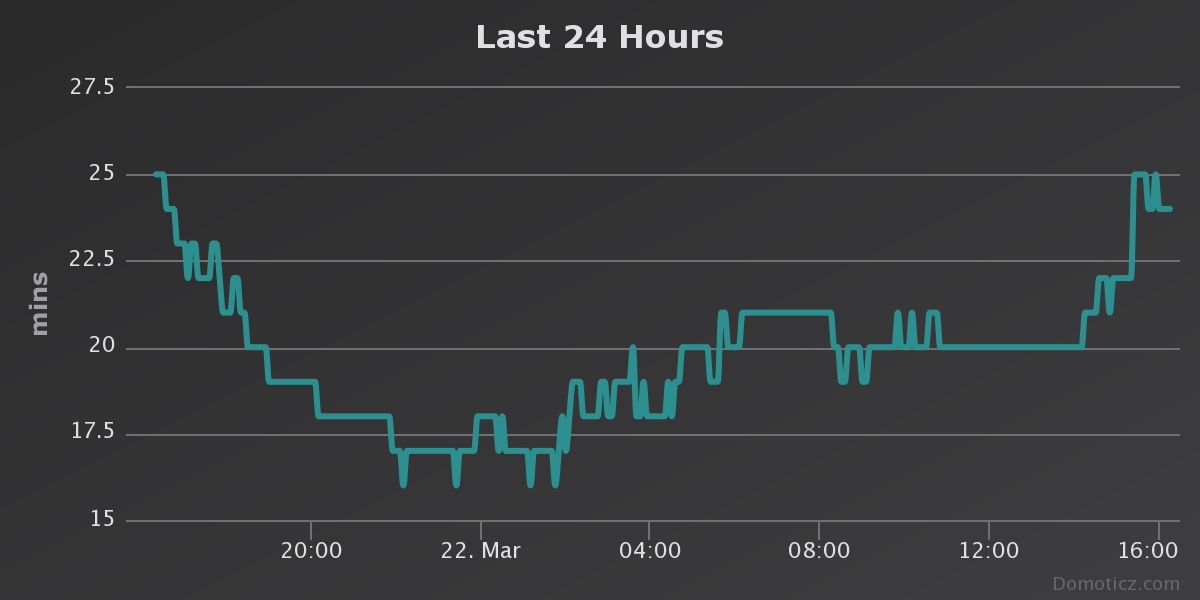

How did you check what were the results over a certain period?
like this : click on "log" on the dummy sensor
Stupid, yes ofcourse. I was thinking a check through the commandline :)
See the picture below, only in the Work to home device I have the drop to 0 minutes

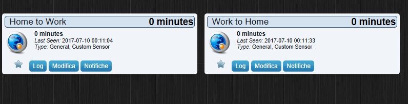

I'm sorry, but I don't understood how configure Waze (in Domoticz running on Windows)
Raspberry PI 3, 3x Yeelight bulbs, 1x Yeeligh led strip, 1x Sonoff with ESP826, Controlicz, Kodi

Which is the procedure to associate the script to the virtual sensor?
