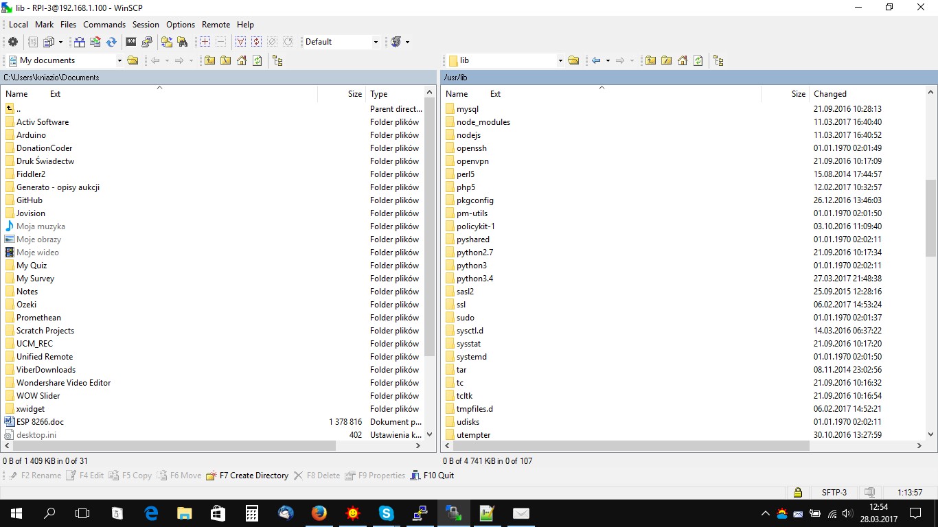

>>> print(os.__file__)
/usr/lib/python2.7/os.pyc
I do not know why he does not use it

Domoticz Python framework require 3.x version.
What you can try , on line 55 of the plugin.py file, add:
sys.path.append('/usr/local/lib/python3.4/dist-packages')
before
import broadlink
but first verify that /usr/local/lib/python3.4/dist-packages is the valid directory to used...

/usr/local/lib/python3.4/dist-packages is emptyzak45 wrote:Domoticz Python framework require 3.x version.
before
import broadlink
Still the same mistakes

@kniazio
don't know how your OS manage different python version.
What I have seen is that Domoticz Python framework is looking on : /usr/lib/python3.4
so... looks like this is the version required / find and that the plugin will use.
when you do : pip install broadlink (or any other command), this should install the module probably there:
maybe for you this go to python2.7 ??

Just test on debian, Domoticz looks lib at
this mean you need to install python who is used for domoticz
When done, you have to copy lib on the good dir :
Then restart domoticz en enjoy !
@zak45 maybe you can update your wiki with this thank you for this great plugin !
when did you release the one for Orange Box ? ahrd to transforme to freebox revolution ?
/usr/local/lib/python3.4/dist-packages/
sudo apt-get install python3-pip libglib2.0-dev
sudo pip3 install Crypto
sudo pip3 install broadlink
sudo cp -r /usr/local/lib/python3.4/dist-packages/Crypto/ /usr/lib/python3.4/
sudo cp -r /usr/local/lib/python3.4/dist-packages/broadlink /usr/lib/python3.4/
sudo service domoticz restart
