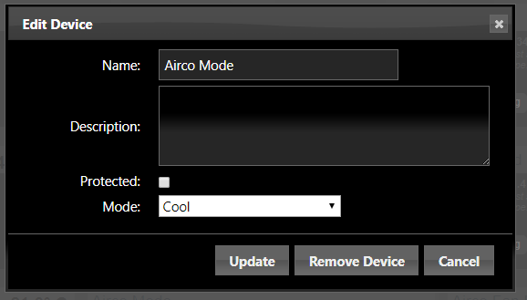

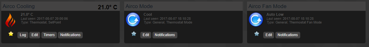

I have the same issue. Just bought a Remotec ZXT-120 to control my A/C.
I can control the temperature but to change the mode/fan mode I have to click "edit" and than select a mode and save, which is quite cumbersome.
On the domoticz app I cannot change it at all which is kind of a showstopper for me.
Was thinking about creating a virtual selector sensor and than set the values accordingly on the real device using some LUA scripting, but maybe I am missing something here?
See the images below to illustrate my issue:
Domoticz (1).png (17.34 KiB) Viewed 993 times
