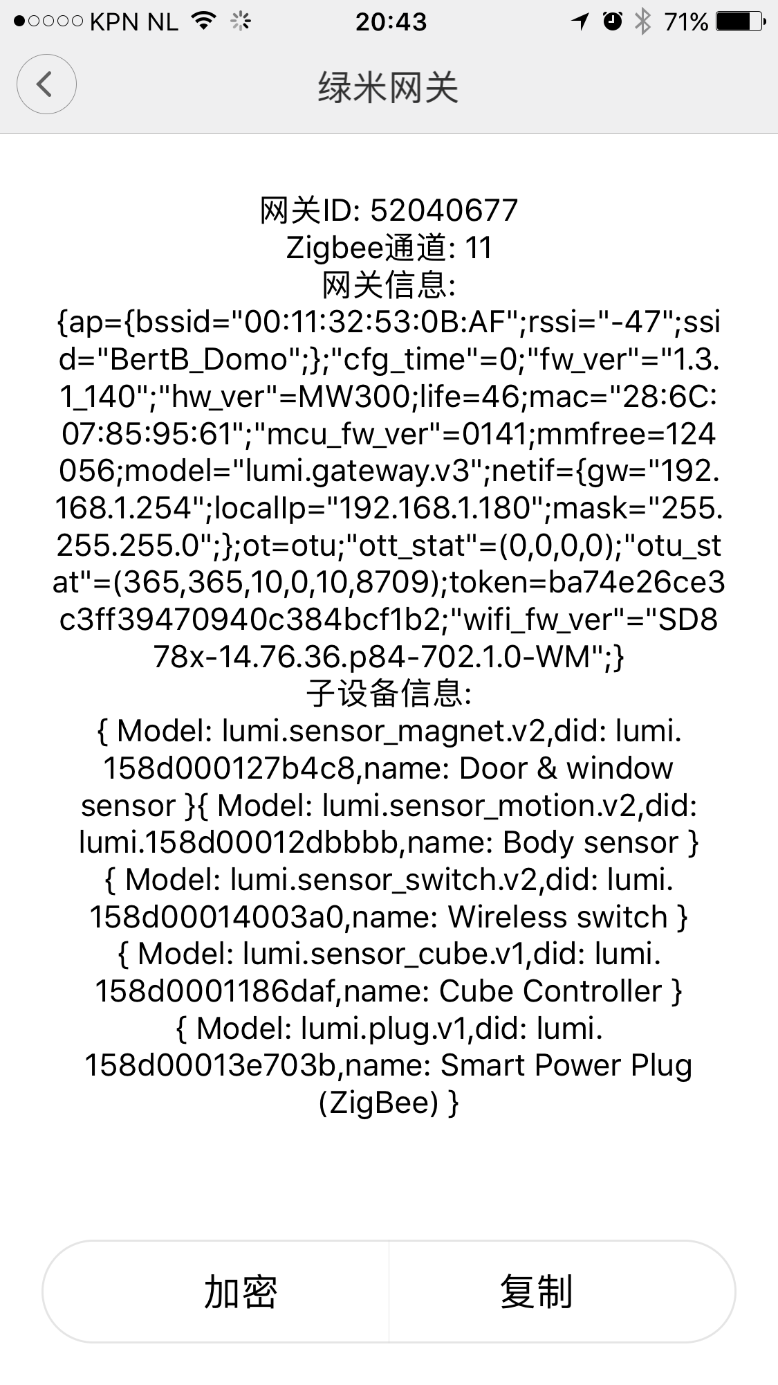

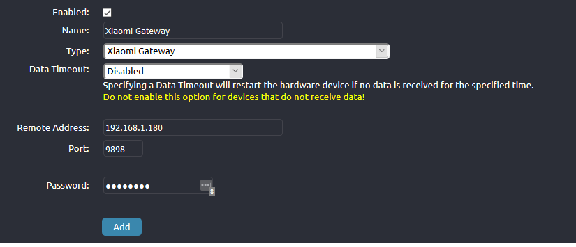

Hi everyone,
I hope someone can help me with the following problem:
I have a Xiaomi Gateway installed.
As you can see in the image the version of the software is 1.3.1_140 and it is also connected to the several devices.
This is my setup for Domoticz
Xiaomi - Domoticz.png (12.83 KiB) Viewed 3551 times
But I don’t see any device in Domoticz occurring
When I inspect the network traffic with Wireshark I see only UDP traffic from 192.168.1.180 port 9966 to 255.255.255.255 port 8875
traffic port 9966 - 8875.jpg (366.77 KiB) Viewed 3551 times
(screenshot from different setup so other source ip number, but result stays)
What I learned from people who have this working I should see UDP traffic from 192.168.1.180 port 4321 to 224.0.0.50 port 9898
I really hope someone can help me with this issue.
Best regards Bert

Hi Everyone,
I finally found out what was wrong in my case
As I wrote I was working with 1.3.1_140 as firmware and it told me also it was up to date.
Yesterday I was playing with the app and because it had a lot of chines I couldn't read all.
But at a certain moment I found that it could set the locale to china mainland and then it moved forward.
(I forgot to make screenshots so I can't share the info where and how I did it with the community, but when someone else has the problem send me a PM and maybe I can help further)
I could update to version 1.4.1_143, after doing so, a lot of chinese turned into English (still some Chinese in the app :D )
I put it in developer mode again (also a good description in https://github.com/lazcad/homeassistant how to do that)
Filled in the new password in domoticz agaian, disabled and enabled the hardware and voila there were my devices.
and now it works!!!!
So everyone thanks for your all the help!
Especially Corbin who put in a lot of private time to help and guide me to make it work. I learned a lot!
Best regards Bert

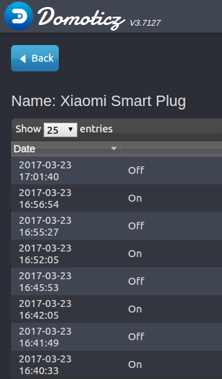

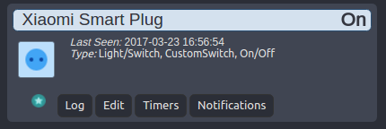

Hi corbin. Since version 3.7xxx, the Smart Plug does not work.
Goes spontaneously to the "off" state after a few minutes.
Today's update from the https://github.com/corbinmunce/domoticz did not fix the problem.
2017-03-23 16:40:32.869 User: ..... initiated a switch command (97/Xiaomi Smart Plug/On)
2017-03-23 16:40:33.019 (Xiaomi) Light/Switch (Xiaomi Smart Plug)
2017-03-23 16:41:49.250 User: ..... initiated a switch command (97/Xiaomi Smart Plug/Off)
2017-03-23 16:41:49.400 (Xiaomi) Light/Switch (Xiaomi Smart Plug)
2017-03-23 16:42:00.239 {"cmd":"heartbeat","model":"plug","sid":"158d00011016d0","short_id":10530,"data":"{\"status\":\"off\",\"inuse\":\"0\"}"}
2017-03-23 16:42:04.948 User: ..... initiated a switch command (97/Xiaomi Smart Plug/On)
2017-03-23 16:42:05.098 (Xiaomi) Light/Switch (Xiaomi Smart Plug)
2017-03-23 16:49:01.206 {"cmd":"heartbeat","model":"plug","sid":"158d00011016d0","short_id":10530,"data":"{\"status\":\"off\",\"inuse\":\"0\"}"}
2017-03-23 16:52:05.745 User: ..... initiated a switch command (97/Xiaomi Smart Plug/On)
2017-03-23 16:52:05.895 (Xiaomi) Light/Switch (Xiaomi Smart Plug)
2017-03-23 16:55:27.154 (Xiaomi) Light/Switch (Xiaomi Smart Plug)
2017-03-23 16:55:27.167 {"cmd":"heartbeat","model":"plug","sid":"158d00011016d0","short_id":10530,"data":"{\"status\":\"off\",\"inuse\":\"0\"}"}
2017-03-23 16:56:54.692 User: ..... initiated a switch command (97/Xiaomi Smart Plug/On)
2017-03-23 16:56:54.842 (Xiaomi) Light/Switch (Xiaomi Smart Plug)
2017-03-23 17:01:40.198 (Xiaomi) Light/Switch (Xiaomi Smart Plug)
2017-03-23 17:01:40.214 {"cmd":"heartbeat","model":"plug","sid":"158d00011016d0","short_id":10530,"data":"{\"status\":\"off\",\"inuse\":\"0\"}"}
