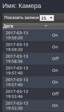

Post by hekm77 »
Thank you, corbin. v3.6912.
Unfortunately, there are no changes with the socket.
Снимок экрана от 2017-03-13 19-59-56.png (26.64 KiB) Viewed 3302 times
2017-03-13 19:55:30.059 (Xiaomi) Light/Switch (Камера)
2017-03-13 19:55:30.141 XiaomiGateway: not updating Domoticz for switch as no change from last state
2017-03-13 19:55:30.141 {"cmd":"report","model":"plug","sid":"158d00011016d0","short_id":41069,"data":"{\"status\":\"on\"}"}
2017-03-13 19:55:31.882 XiaomiGateway: not updating Domoticz for switch as no change from last state
2017-03-13 19:55:31.882 {"cmd":"heartbeat","model":"motion","sid":"158d0001173873","short_id":32522,"data":"{\"status\":\"no_motion\"}"}
2017-03-13 19:55:39.726 Incoming connection from: 5.104.179.16
2017-03-13 19:55:45.862 User: Admin initiated a switch command (9/Камера/Off)
2017-03-13 19:55:46.012 (Xiaomi) Light/Switch (Камера)
2017-03-13 19:55:46.525 XiaomiGateway: not updating Domoticz for switch as no change from last state
2017-03-13 19:55:46.525 {"cmd":"report","model":"plug","sid":"158d00011016d0","short_id":41069,"data":"{\"status\":\"off\"}"}
2017-03-13 19:56:00.082 LUA: TV ping success
2017-03-13 19:56:00.182 LUA: TV says it is active
2017-03-13 19:56:00.182 LUA: TV active, status is ON, so do nothing.
2017-03-13 19:57:00.236 LUA: TV ping success
2017-03-13 19:57:00.338 LUA: TV says it is active
2017-03-13 19:57:00.338 LUA: TV active, status is ON, so do nothing.
2017-03-13 19:57:40.149 User: Admin initiated a switch command (9/Камера/On)
2017-03-13 19:57:40.292 (Xiaomi) Light/Switch (Камера)
2017-03-13 19:57:40.311 {"cmd":"report","model":"plug","sid":"158d00011016d0","short_id":41069,"data":"{\"status\":\"on\"}"}
2017-03-13 19:57:40.311 XiaomiGateway: not updating Domoticz for switch as no change from last state
2017-03-13 19:57:40.311 (Xiaomi) Light/Switch (Камера)
2017-03-13 19:58:00.465 LUA: TV ping success
2017-03-13 19:58:00.626 LUA: TV says it is active
2017-03-13 19:58:00.626 LUA: TV active, status is ON, so do nothing.
2017-03-13 19:58:09.067 XiaomiGateway: not updating Domoticz for switch as no change from last state
2017-03-13 19:58:09.067 {"cmd":"heartbeat","model":"plug","sid":"158d00011016d0","short_id":41069,"data":"{\"status\":\"on\",\"inuse\":\"0\"}"}
2017-03-13 19:58:36.651 User: Admin initiated a switch command (9/Камера/Off)
2017-03-13 19:58:36.817 XiaomiGateway: not updating Domoticz for switch as no change from last state
2017-03-13 19:58:36.817 {"cmd":"report","model":"plug","sid":"158d00011016d0","short_id":41069,"data":"{\"status\":\"off\"}"}
2017-03-13 19:58:36.802 (Xiaomi) Light/Switch (Камера)
2017-03-13 19:59:00.239 LUA: TV ping success
2017-03-13 19:59:20.835 User: Admin initiated a switch command (9/Камера/On)
2017-03-13 19:59:20.951 (Xiaomi) Light/Switch (Камера)
2017-03-13 19:59:20.965 {"cmd":"report","model":"plug","sid":"158d00011016d0","short_id":41069,"data":"{\"status\":\"on\"}"}
2017-03-13 19:59:20.965 XiaomiGateway: not updating Domoticz for switch as no change from last state
2017-03-13 19:59:20.985 (Xiaomi) Light/Switch (Камера)

Post by hekm77 »
I see two "on" when on and two "off" when off
2017-03-13 22:05:29.423 User: Admin initiated a switch command (9/Камера/On)
2017-03-13 22:05:29.564 (Xiaomi) Light/Switch (Камера)
2017-03-13 22:05:29.581 {"cmd":"report","model":"plug","sid":"158d00011016d0","short_id":41069,"data":"{\"status\":\"on\"}"}
2017-03-13 22:05:29.581 XiaomiGateway: not updating Domoticz for switch as no change from last state
2017-03-13 22:05:29.582 {"cmd":"report","model":"plug","sid":"158d00011016d0","short_id":41069,"data":"{\"status\":\"on\"}"}
2017-03-13 22:05:29.581 (Xiaomi) Light/Switch (Камера)
2017-03-13 22:05:38.915 User: Admin initiated a switch command (9/Камера/Off)
2017-03-13 22:05:38.985 (Xiaomi) Light/Switch (Камера)
2017-03-13 22:05:39.008 {"cmd":"report","model":"plug","sid":"158d00011016d0","short_id":41069,"data":"{\"status\":\"off\"}"}
2017-03-13 22:05:39.066 (Xiaomi) Light/Switch (Камера)
2017-03-13 22:05:39.087 XiaomiGateway: not updating Domoticz for switch as no change from last state
2017-03-13 22:05:39.087 {"cmd":"report","model":"plug","sid":"158d00011016d0","short_id":41069,"data":"{\"status\":\"off\"}"}
