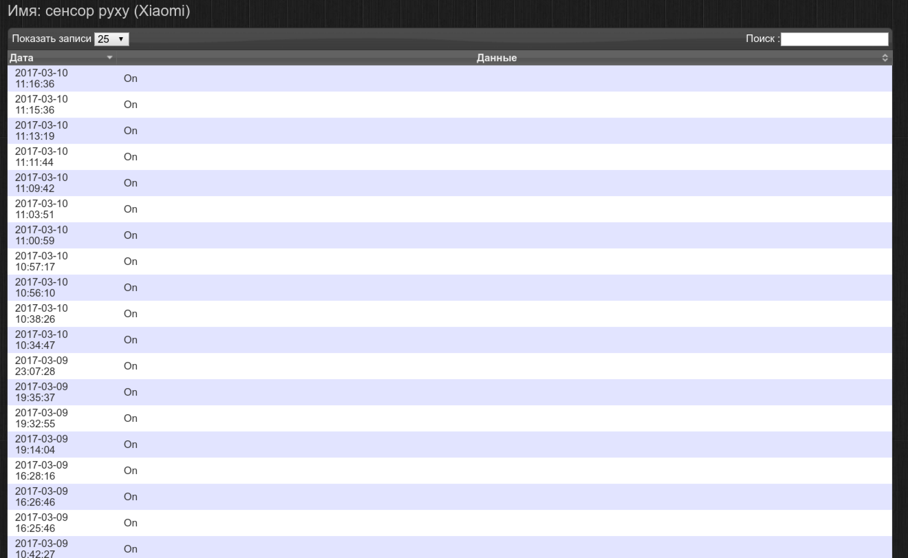

Hello. I have a problem :(
My motion sensor and door sensor always "on".
Why?
In logs all good:
2017-03-10 11:20:20.274 {"cmd":"report","model":"magnet","sid":"158d0001067c44","short_id":43290,"data":"{\"status\":\"open\"}"}
2017-03-10 11:20:31.471 XiaomiGateway: not updating Domoticz for switch as no change from last state
2017-03-10 11:20:31.471 {"cmd":"report","model":"magnet","sid":"158d0001067c44","short_id":43290,"data":"{\"status\":\"close\"}"}
2017-03-10 11:21:35.752 XiaomiGateway: not updating Domoticz for switch as no change from last state
2017-03-10 11:21:35.752 {"cmd":"report","model":"motion","sid":"158d00010ecca5","short_id":4134,"data":"{\"no_motion\":\"300\"}"}
corbin
Posts: 463
Location: Brisbane, Australia
Post by corbin »
can you compile my github repo again and post the log output? looking at the log output here
if ((((bIsOn) && (nvalue == 0)) || ((bIsOn == false) && (nvalue == 1))) || (messagetype != "heartbeat" && bIsOn == true)) {
			m_mainworker.PushAndWaitRxMessage(this, (const unsigned char *)&xcmd, NULL, -1);
		else {
			_log.Log(LOG_STATUS, "XiaomiGateway: not updating Domoticz for switch as no change from last state");
			if (bIsOn) {
				_log.Log(LOG_STATUS, "bIsOn = true");
			else {
				_log.Log(LOG_STATUS, "bIsOn = false");
			_log.Log(LOG_STATUS, "nvalue = %d", nvalue);
			_log.Log(LOG_STATUS, "messagetype = %s", messagetype.c_str());
