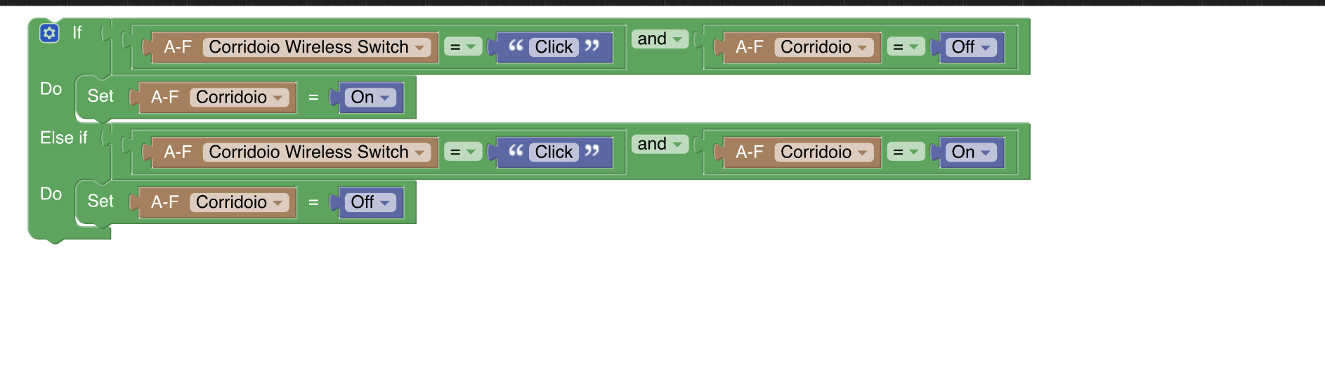

Speaking of "click"... I use the switch in mihome app to "rurn on/off" a yeelight bulb. How can I do the same thing in domoticz? I tried with blocky (like "if off click turn on else if off click turn off) and I obtain a funny loop in the log :D

marcotrumpet wrote:Speaking of "click"... I use the switch in mihome app to "rurn on/off" a yeelight bulb. How can I do the same thing in domoticz? I tried with blocky (like "if off click turn on else if off click turn off) and I obtain a funny loop in the log :D
if switch = click and bulb = on then bulb = off
if switch = click and bulb = off then bulb = on
marcotrumpet
Posts: 102
Joined: Saturday 18 February 2017 8:21
Post by marcotrumpet »
I did but I was into loop
deennoo
Posts: 784
Location: Bordeaux France
Re: RE: Re: RE: Re: Xiaomi Smart Home Suite (very cheap) compatibilty?
Post by deennoo »
marcotrumpet wrote:
Which kind of switch ? The wireless wall one or the round one ?
Which domoticz version
Which gateway fw
We need to know that
http://domo-attitude.fr
marcotrumpet
Posts: 102
deennoo wrote:
marcotrumpet wrote:
hekm77 wrote: if switch = click and bulb = on then bulb = off
Which gateway fw
You're right, I'm sorry.
I'm using the round switch on 3.10.0 fw gateway version in domoticz 6863 beta version.

marcotrumpet wrote:
deennoo wrote:
marcotrumpet wrote: I did but I was into loop
Which gateway fw
Hum forget about blocky event "switch" for LUA, more flexible more Powerfull.

deennoo wrote:
marcotrumpet wrote:
deennoo wrote: Which kind of switch ? The wireless wall one or the round one ?
Which gateway fw
I know hut I need time to study it.. at thw time it's ok with mihome app.

marcotrumpet wrote:
deennoo wrote:
But LUA is your only solution, perfection need some works on DIY
