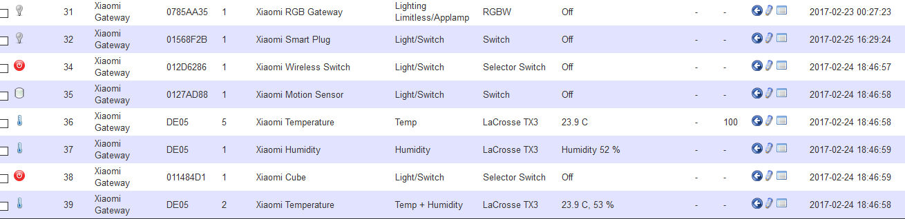

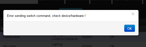

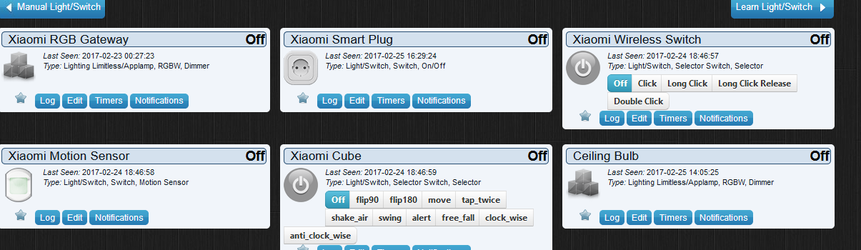

Levynger - Thanks for your input but unfortunately I'm still a bit lost.
I have the Xiaomi Gateway set to port 9898
In Devices this is what I have:
You will see that Xiaomi Gateway, Smart Plug, Sensor, Switch and Cube are all listed as 'off'.
And if I click on the light bulb on the left hand side of the screen for Xiaomi RGB Gateway for example to turn it on I get this:
So I guess I need to get these turned on but I don't know how.
In the Switches tab I have this:
Sorry if I don't explain myself very well but I'm struggling here to set it up right.

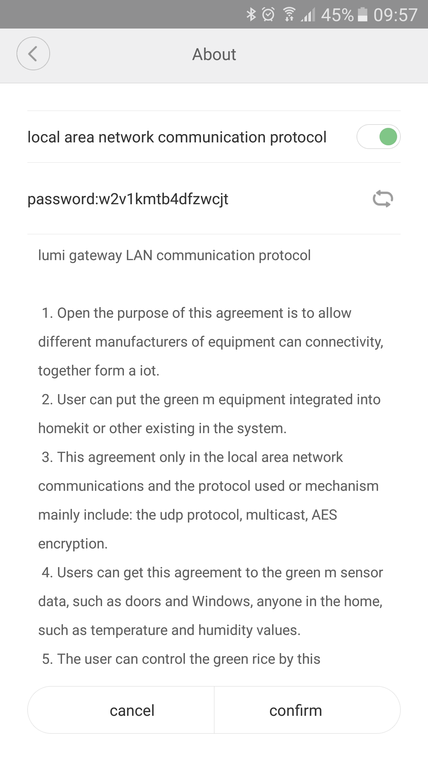

corbin wrote:@Kwintessens
Can you post the exact key you have entered for the Gateway? (you can change it later if you are worried about security)
Also If you want to troubleshoot, please setup a test vm running Windows or Linux, and compile my github repo at https://github.com/corbinmunce/domoticz
I've tried multiple times with the password from the app, as instructed:
Am I missing anything? I find it strange it updates/adds devices initially but stops working thereafter. In the meantime I will run a VM as soon as I have access to my notebook.

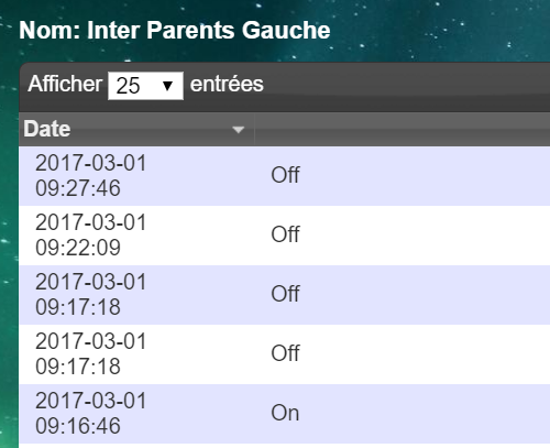

Using 3.6807, i'm facing a issue :
Heartbeat doesn't only update status, it change statut device too :
Using a 230v double switch, one button is connected to a real bulb, no probleme with this, the second oneis use to drive a yeelight bt bedside lamp (will provid an how to to drive it later) via a script
if 230 switch statut change (no matter on or off) and bed side lamp is off then turn on bed side lampe
elseif  230 switch statut change (no matter on or off) and bed side lamp is on then turn offbed side lampe
advantage to don't care about on or off switch state is that action act as a simple push on button
but heartbeat trigger script each time he "update" or check the device :
2017-03-01 09:22:10.053 User: Admin initiated a switch command (2704/Chevet Nico/Off)
2017-03-01 09:22:10.053 {"cmd":"heartbeat","model":"ctrl_neutral2","sid":"158d000153b50f","short_id":18029,"data":"{\"channel_0\":\"off\",\"channel_1\":\"off\"}"}
2017-03-01 09:22:10.233 Executing script: /home/nico/domoticz/scripts/shell/yeelightbt/off.sh
it confirm by the log
No way to just update device if heartbeat provid a different status from the last one ?
exemple : if heartbeat for ctrl_neutral2 channel_0 = Off and Channel 0 is already Off then do nothing, else if Channel 0 is On then update
