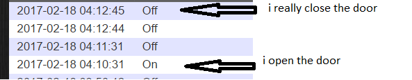

yes door sensor says close after 1minutes open while door is always open ...
Last edited by zaraki673 on Saturday 18 February 2017 4:17, edited 1 time in total.
corbin
Posts: 463
Location: Brisbane, Australia
Post by corbin »
can you post the logs from the time the state changed to closed but the door was open?
zaraki673
Posts: 32
Joined: Thursday 19 January 2017 23:46
Post by zaraki673 »
status log is enough ?
2017-02-18 04:10:31.838 {"cmd":"report","model":"magnet","sid":"158d0001082b75","short_id":23864,"data":"{\"status\":\"open\"}"}
2017-02-18 04:11:31.696 {"cmd":"report","model":"magnet","sid":"158d0001082b75","short_id":23864,"data":"{\"no_close\":\"60\"}"}
2017-02-18 04:12:44.100 {"cmd":"report","model":"magnet","sid":"158d0001082b75","short_id":23864,"data":"{\"status\":\"close\"}"}
2017-02-18 04:12:45.313 {"cmd":"heartbeat","model":"magnet","sid":"158d0001082b75","short_id":23864,"data":"{\"status\":\"close\"}"}
