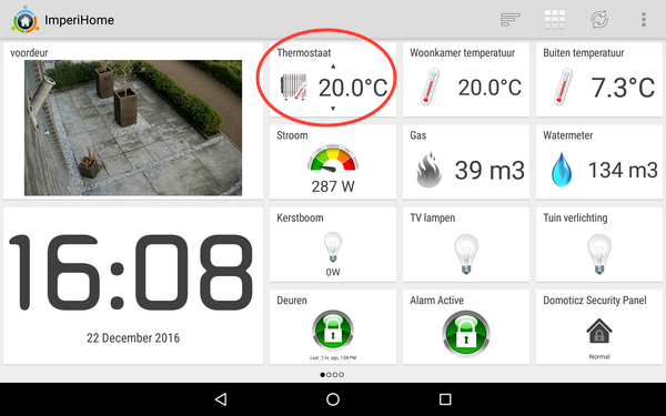

Hi.
Does anyone know why some of my devices show up as "no group" in the imperihome app? Seems to be only the "dimmer" devices in domoticz that isnt recognized as a switch/dimmer in imperihome. the "no group" tab isnt in my IOS app(only scenes, switches and utility), so its kinda annoying only being able to access my devices from android(which I do not use).
is there something I could have done wrong when setting up domoticz/MDAH gateway? what could I try to do to fix this?

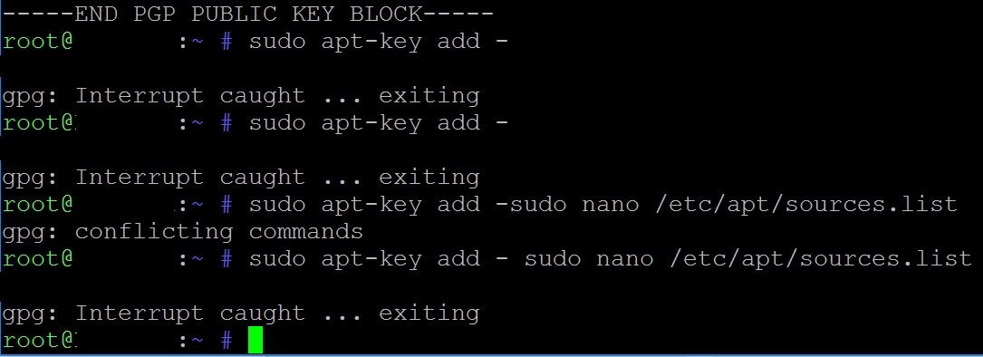

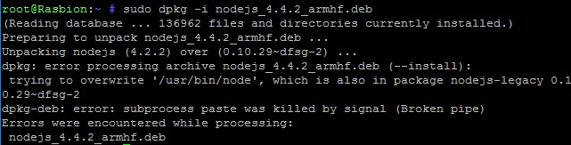

Error by install by step sudo apt-get install MyDomoAtHome
E: Unable to locate package MyDomoAtHome
Also this error when trying to install node, see attachment
long time domiticz user, running 8 domoticz installations on vm's nuc i3. And espeay hosting more than 30.

anno
Posts: 36
Joined: Wednesday 01 March 2017 13:00
Domoticz version: all
Re: [MyDomoAtHome] Support thread
Post by anno »
anno wrote:Error by install by step sudo apt-get install MyDomoAtHome
So nobody here knows something about this. than also not about the following:
mlamie
Posts: 122
Joined: Friday 25 October 2013 17:12
Domoticz version: 3.5877
Post by mlamie »
Don't know if it solves the issue, but on the github installation page it says: Important remark: do not install as roos (I expect a typing error = root), but sudo as an unprivilegied user
