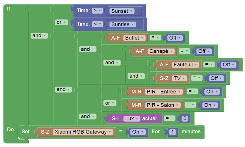

As far as I know it is not possible at the moment.mKotek wrote:Any ideas, how to setup Blocky to support setting color, brightness
I have this blocky which is working fine for the moment. I will move to lua asap.mKotek wrote:and duration correctly?

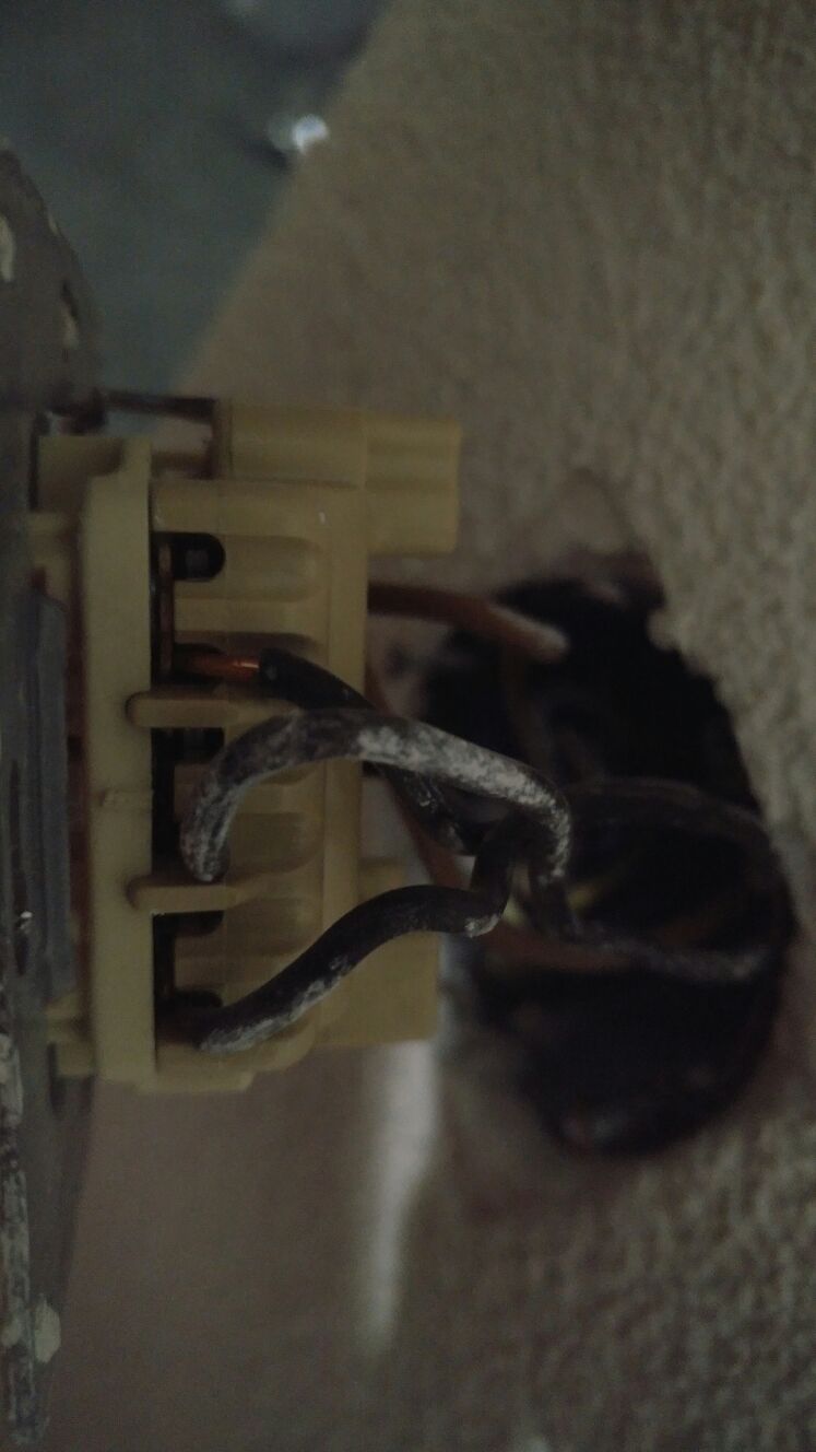

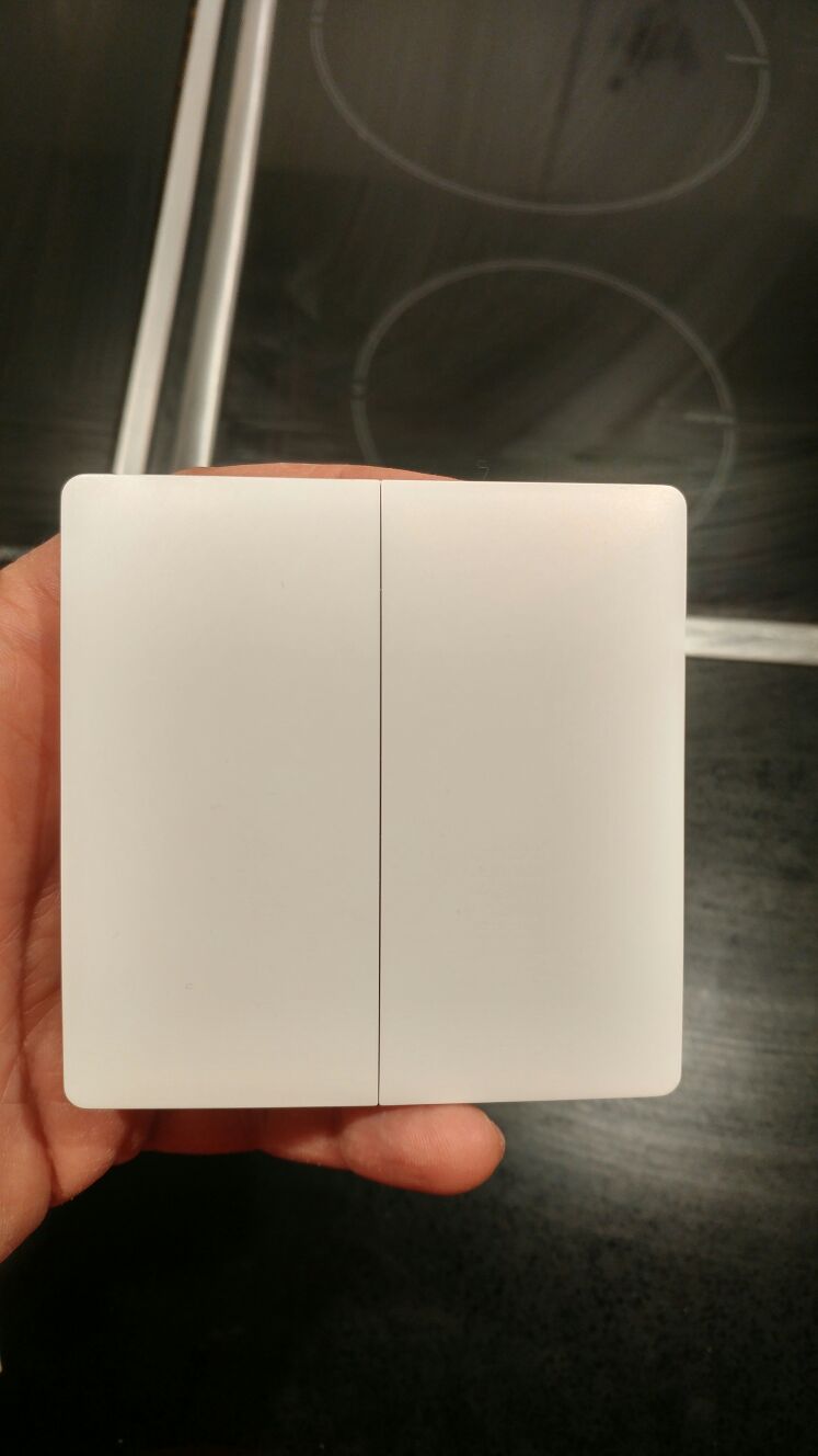

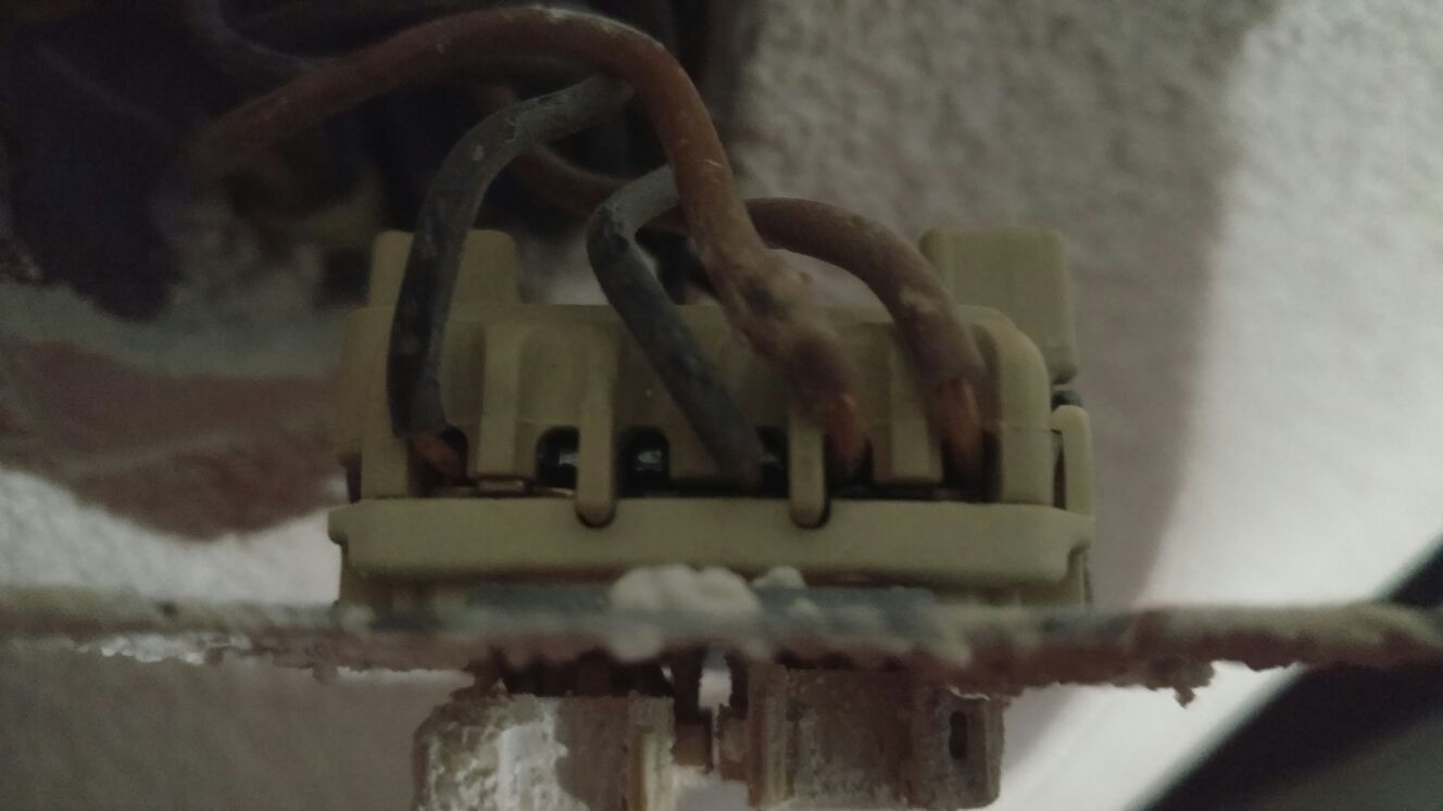

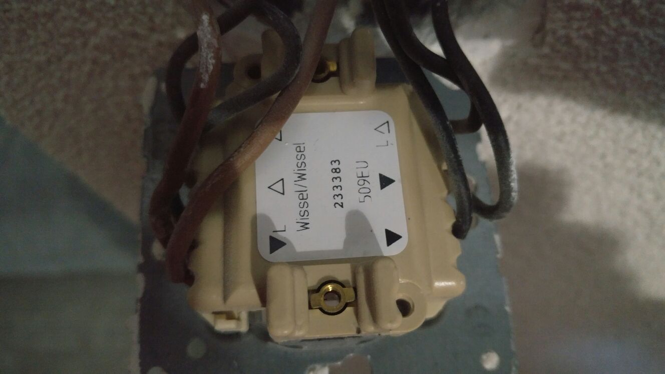

Can anybody help me out installing the Xiaomi Aqora in wass switches. the amount of wires connected on my standard due switch are more then 3??

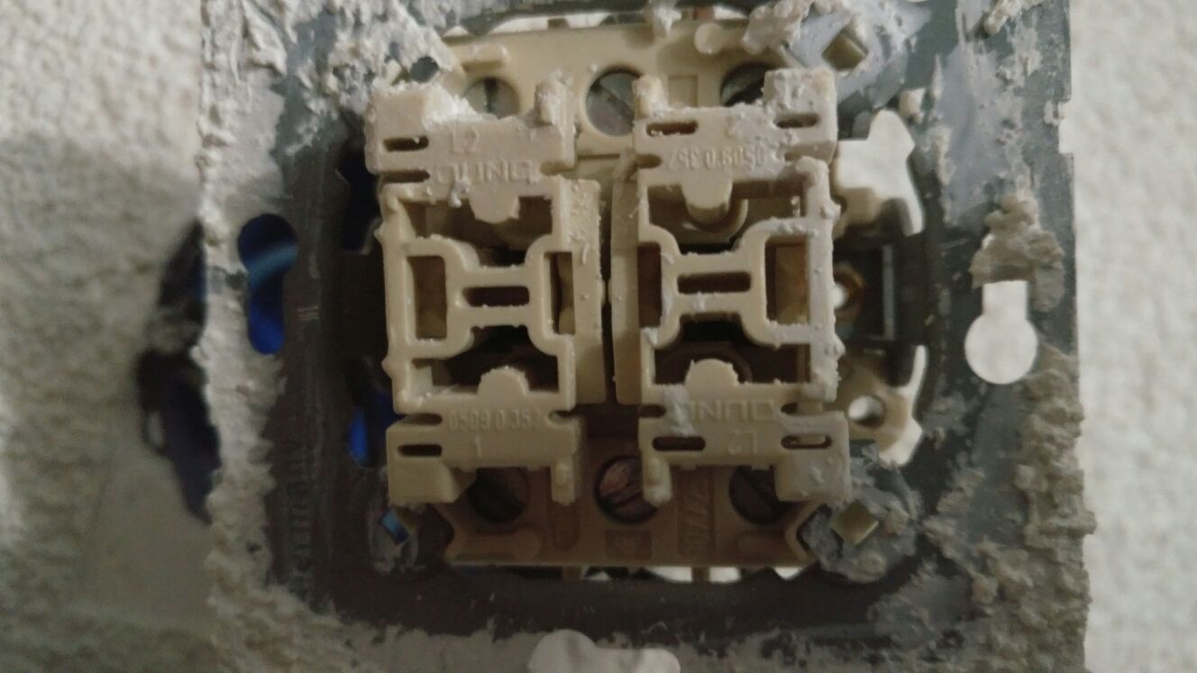

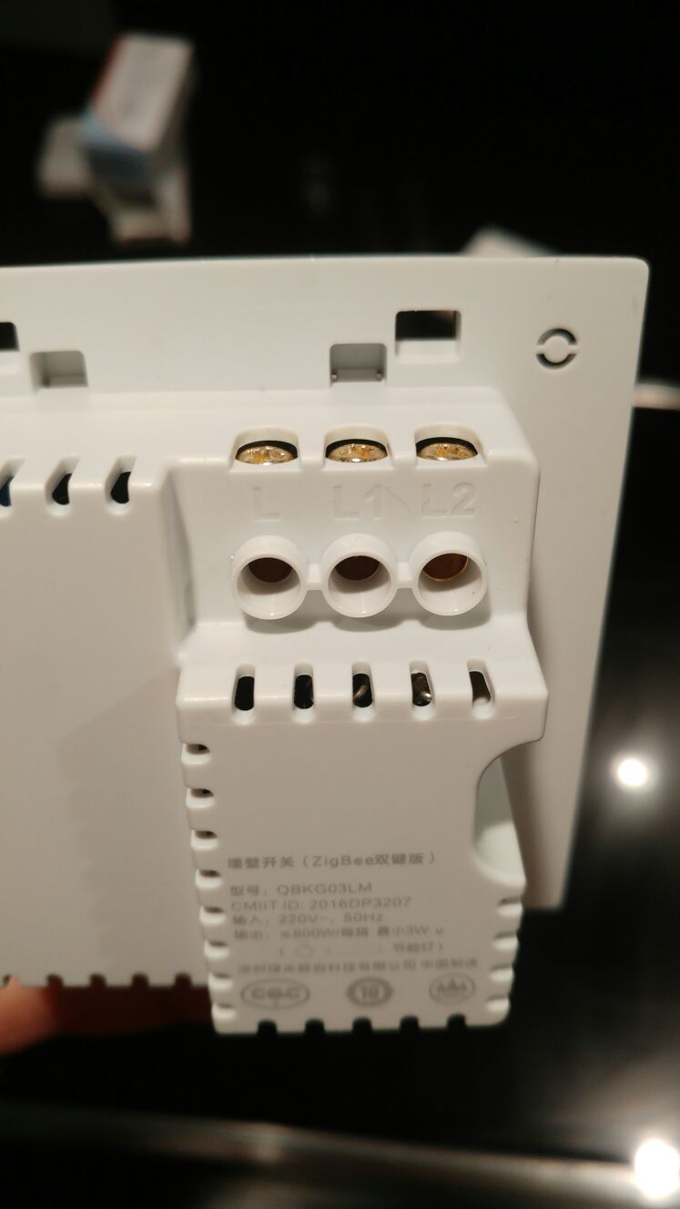

Here more pictur

Whaou hard to help from internet.
You have to find which one is the main/phase/line and which ones goes to your light.
Use a screw like this :
If light turn one that the phase/line who have to be plug to L
Becarefull with main ac !

The aqara uses one main in (L) and two for the lights (l1, l2)
The lights itself do have the neutral (blue)
So, in your case you only need the one brown to the aqara l1, the blacks are (hopefully) going to the lights and can be connected to the aqara l1 and l2
Other browns are either not needed or connected to a wall socket or something else, that you have to find yourself

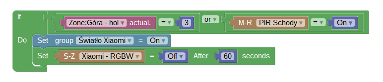

Thank you, I have indeed created a group, set desired color and brightness and created a following blocky: I am actually using 2 PIR sensors - one is Satel alarm PIR and the other is Xiaomi Body Sensor (depending on which side of stairs one is at.deennoo wrote:Why don't you use scene or group ?
Set a group with you gateway to your color
And use it with your blocky or lua !
This way you can choose color brightness etc etc.
The only issue is Xiaomi PIR seems to have 120s of timeout for motion detection and I am turning the LED only for 60s. So if someone is coming back after 60s and before 120s, Xiaomi does not react, Satel one does. Have not seen a way to solve it and I made sure, I have disabled all scenes on Mi Home App.

Note that you may also have 2 or 3 way switch there.
If you have more then a single switch that can turn on/off the same light, you'll have to disable them first.. Making sure the switch will constantly push the line to the light and not to the 2nd switch.
Anyway, the Aqara does not support 2 way switch.. That's why you'll have to disable them..
Check 2 way switch sketch on Google to understand what your are facing..
Sent from my SM-N920C using Tapatalk

The minimum gap for detection is 60 seconds last time I have checked.mKotek wrote:Thank you, I have indeed created a group, set desired color and brightness and created a following blocky: I am actually using 2 PIR sensors - one is Satel alarm PIR and the other is Xiaomi Body Sensor (depending on which side of stairs one is at.deennoo wrote:Why don't you use scene or group ?
There is no way to lower that as far as it looks. It is how the xiaomi gateway reports..
