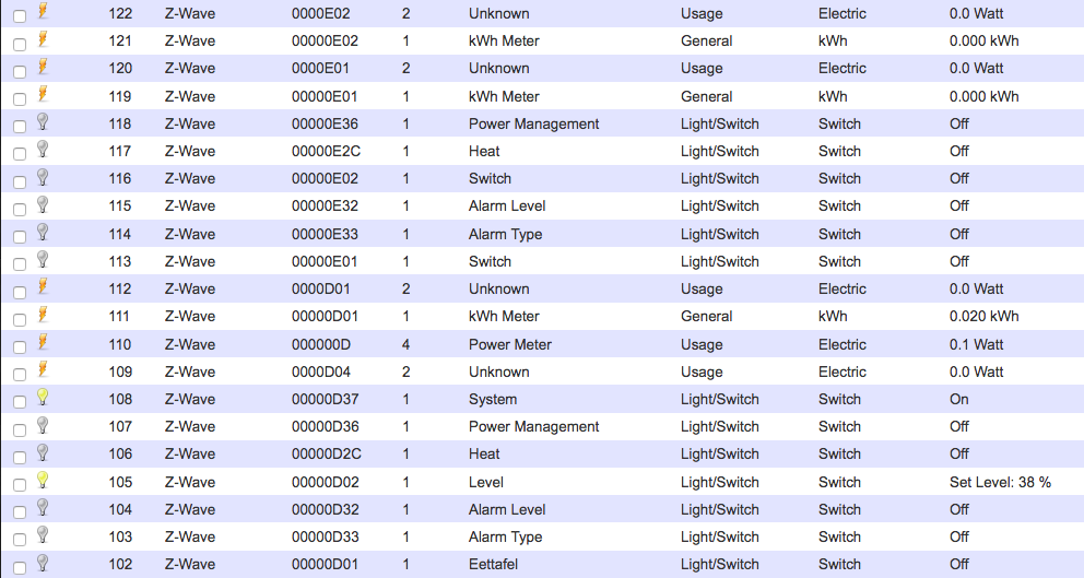

Last week I've added an second Fibaro dimmer type 2 to my zwave network.
Inclusion was no problem, but only 3 new devices show up in the devices list.
2 times usage and 1 kwh meter (see attached screenshot).
The light itself is not visible as device, so I can't controll the light via Domoticz.
I allready tried removing and adding it again, but still only 3 devices show up.
Is the Fibaro dimmer broke, or am I doing something wrong?

Did you try to reset it before adding again ?

you need to give it more time.
you need a couple of watt devices, kwh devices, lightswitch and scene devices
sometimes you get more than one device which does the same so you have to look which one is active/will react
include the device and make sure you have allow new devices set to on in setup.
after the module is recognized start switching (push switch 1, switch 2)
this will probably generate the devices
with s2 you can generate devices for 1 click, 2 clicks, 3 clicks, click and hold, release.

Resetting it did the trick. After resetting and including it, 21 new devices showed uptontze wrote:Did you try to reset it before adding again ?
- Schermafbeelding 2017-01-30 om 13.31.50.png (163.42 KiB) Viewed 1709 times

Re: Missing devices with FIBARO System FGD212 Dimmer 2
now you have to check what they do.
also your screenshot shows 2 devices(D and E)
if you have one device then D is probably the old device which does not work anymore so E are the active ones
