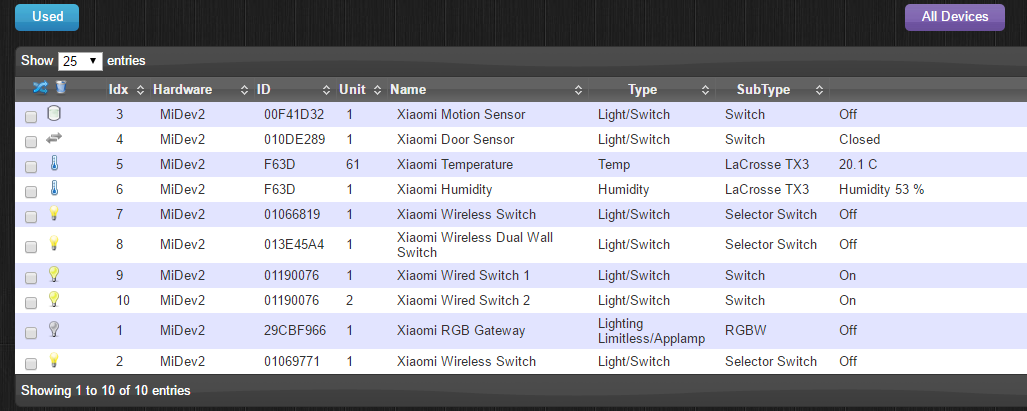

levynger wrote: I though removing it before sending to HW again..
the other issue was it could overflow the maximum int value, eg:
shortened sid hex: 012932CF
add 1 to the front to signify switch type: 1012932CF
convert 1012932CF to int: 4314444495
maximum int value: 2147483647
but if we reduced the hex string to 7 chars it could work. That would be assuming that the first number is always going to be 0 when shortened to 8 chars.
levynger wrote: UPDATE: found how to make 2 on/off type for the same HW.. had to change the xcmd.unitnumber before providing it to mainworker!
did you want to have 2 devices for the same switch?

levynger
Posts: 87
Joined: Wednesday 21 December 2016 19:03
Location: Israel
Post by levynger »
yes, at certian point i have figured this one out, and dripped all changes andnreverted back to your original code, now using array strings, as you have suggested, and adding the ID of the ctrl2 devices there.
and in writetohardware function, i can identify this device by matching the xcmd id with the strings array.
indeed, seems more logical to have 2 seperated on/off switches for the ctrl2 and a single on/off for the ctrl1
for the wireless switch (sw086) it should remain slector , as there is additonal trigger i have missed (both pressed).

Post by levynger »
@corbin, added 2 new patches to your github for the cpp and the header file.
its a big change, as discuss previously in in this thread:
1) added string array to store all ID of the ctrl_neutral (1+2), so can be identified when creating them in Database, using "Unit Field" (for the dual switch), and when using from UI as well.
1) changed the ctrl_neutrals to on/off switches (i think upgrades will have to change it manually, or clean their deviceStatus table from ther database, as it wont change an exiting ID in this table
seems to work nicely here on my ctrl_neutral2 device, this time, kept in mind to deal with ctrl_neutral1 device, eventhough i dont have it.

corbin wrote:
levynger wrote:@corbin, added 2 new patches to your github for the cpp and the header file.
Thank you, I would have had much trouble doing it since I don't have these switches.
Thanks, updated from your git & compiled - seems to be working fine..
