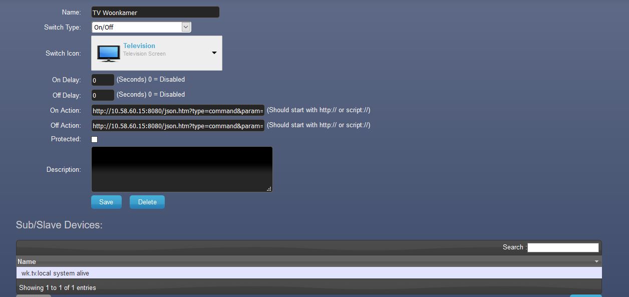

4. Create a dummy switch e.g TV Woonkamer.

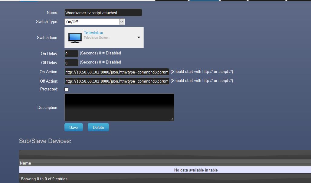

5. Create a dummy switch e.g TV Woonkamer.tv.script attached
6. Link the on and off actions ( via JSON), of the TV woonkamer switch to the TV Woonkamer.tv.script attached
switch
http://ip 1:8080/json.htm?type=command&param=switchlight&idx=95&switchcmd=On
http://ip 1:8080/json.htm?type=command&param=switchlight&idx=95&switchcmd=Off
7. Make the system alive checker device slave (wk.tv.local system alive) of the TV Woonkamer switch.
8. Link the on and off actions ( via JSON) of the TV Woonkamer.tv.script attached switch to the switch on the CEC pi
http://ip 2:8080/json.htm?type=command&param=switchlight&idx=1&switchcmd=On
http://ip 2:8080/json.htm?type=command&param=switchlight&idx=1&switchcmd=Off

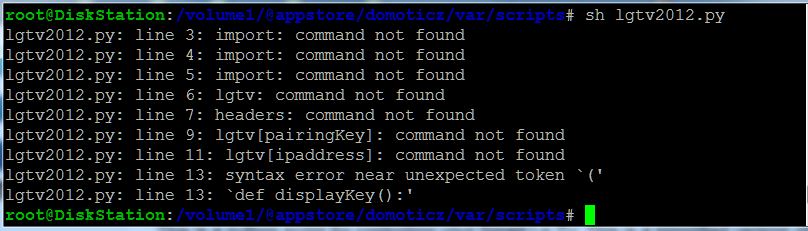

When a first run this script a get following errors in putty.
A must say that a run domoticz on my synology nas. Python is installed because a can run other python scripts with domoticz.
A have my ip adress from my lg television inserted.
Note: when a searching in the forum with the keywords 'lg' , then there 's no search because of two letters. Also 'tv' ;)

Thats because you are trying to run an python script with shell (sh)
try to run it using the following command:
python lgtv2012.py
