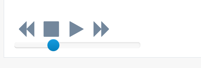

currently also busy creating an MPD plugin to control an MPD server
just the basics of course, because for me html and css is an pain in the *..*
an example for what i've got now:

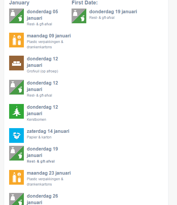

I have a few questions:
- The top_tiles icons on dashboard.jpg look ordered. Is that right? If so, how did you do it?
- How can I get data from Afvalwijzer?
Txs!
Above code will generate 3 lines of top tiles.Code: Select all
components = top_tiles[1], top_tiles[2], top_tiles[3] [[top_tiles]] [[[1]]] example = 1 [[[2]]] example = 2 [[[3]]] example = 3
For data from afvalwijzer jou have to install Afvalwijzer plugin. If you have updated domoboard you can go to settings and install from there.

I find that for the afvalwijzer plugin the number of spaces in front of the "zipcode" determines if the parsing is correct. With exaclty 4 spaces it works. One more and it does not.
