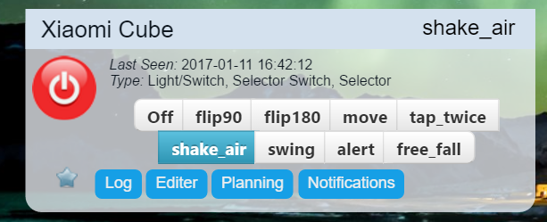

New Gateway FW 1.4.1_143.0141 UPDATE
Magic cube works ! with Domoticz Version: 3.6327
2017-01-11 16:42:12.675 {"cmd":"report","model":"cube","sid":"158d00010eebac","short_id":31286,"data":"{\"status\":\"shake_air\"}"}

deennoo wrote:New Gateway FW 1.4.1_143.0141 UPDATE
Great!
The cube was quick to add, the gateway light will take a bit more work due to it needing to be RGB like a colour Yeelight - it won't work with the existing switch code.
