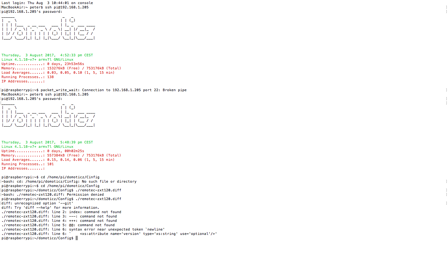

I have the same problem I think. It seems to that the remotec is online in domoticz, but when most of the time I send a command, the domoticz logs tells the remotec is offline (timeout)
Where do I find the open z-wave folder to execute the patch from ?

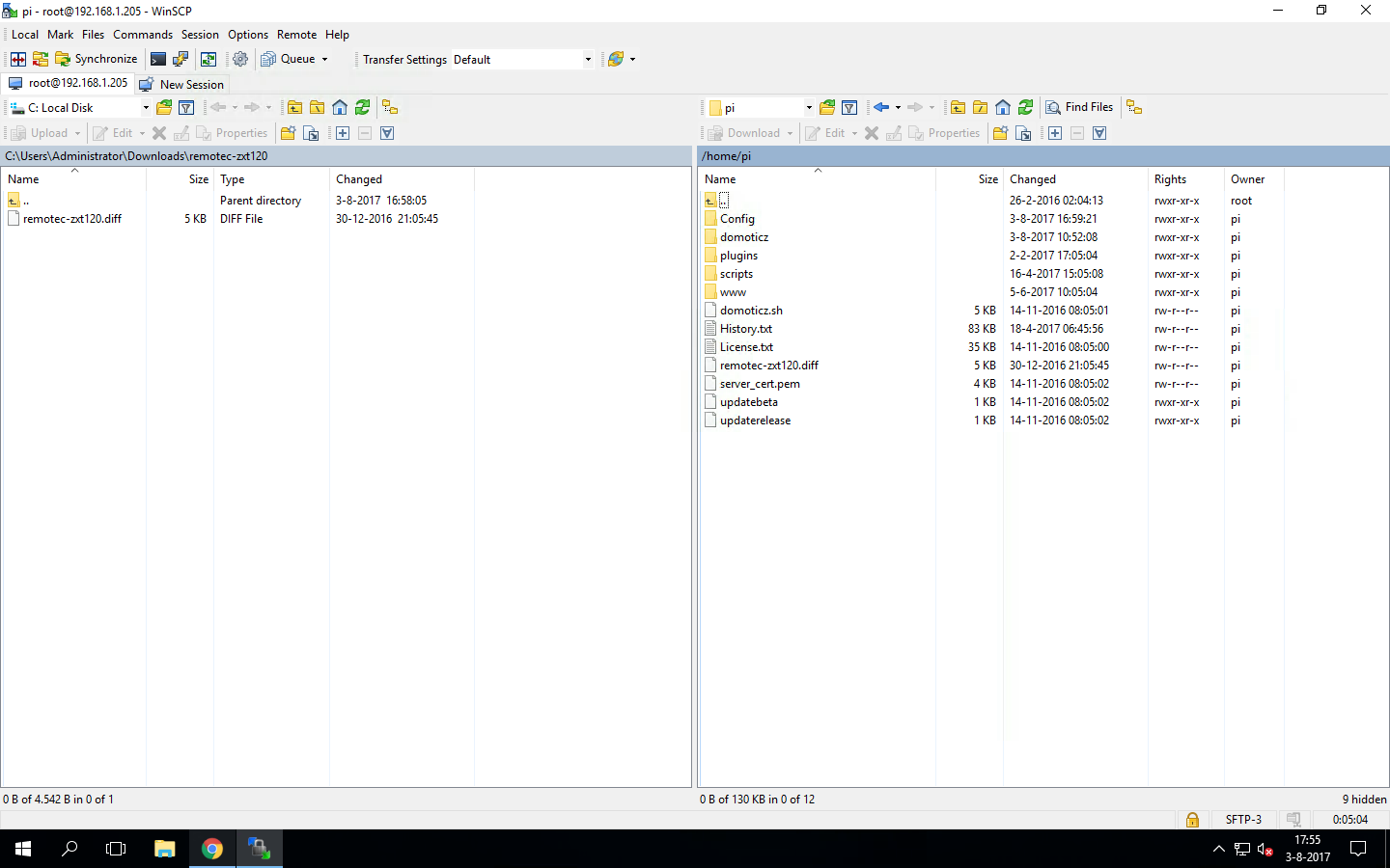

I did leave a message in de github toppic. I did buy the remotec to get my airco working, but I don't have anything on the remotec this way. I did get a new one, because they thought it was maybe defective. That is not true, the new one has the same problem.
I would do it by my self, but I don't know, where I can find the files to modify. Installing the patch is not necessary then ? I did not know where I could find the open z-wave folder to execute the patch from.

Re: ZXT-120
Where is the folder to execute patch from ? I did what I thought was wright, but thats not good. See te screen shots. Who can help ?
Greetings,
Peter
Greetings,
Peter
