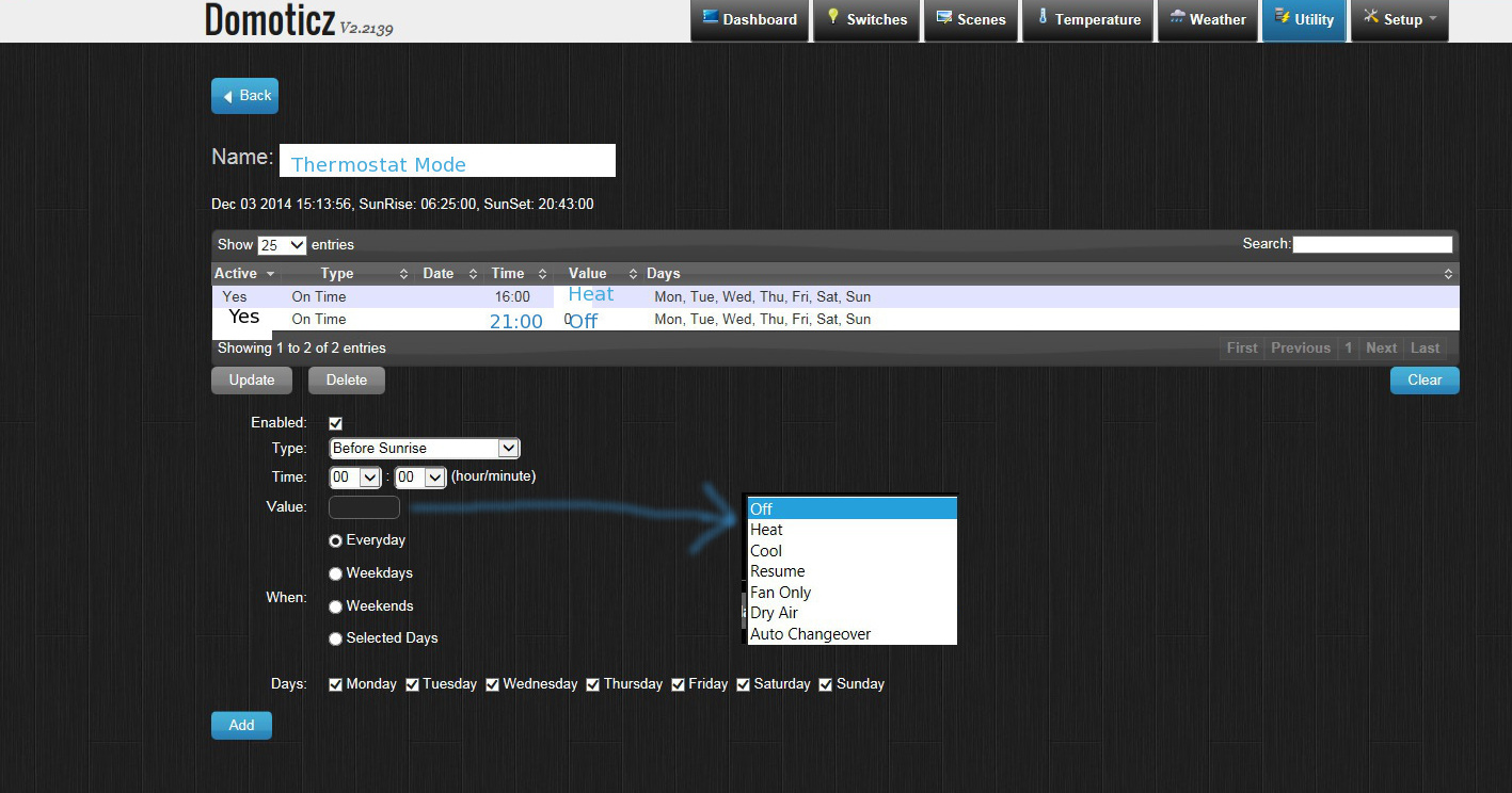

Re: ZXT-120
In version #2122:
Implemented:
- COMMAND_CLASS_THERMOSTAT_MODE
- COMMAND_CLASS_THERMOSTAT_FAN_MODE
Also updated the ZXT-120 configuration file
After the update:
- stop domoticz (from the ssh shell)
- Edit the file Config/zwcfw_xxxxxx.xml) remove all ZXT-120 nodes, be carefull here
- If the above step is to complex, you can also delete this file, but you might need to wakeup all your nodes to get all information correct
- start domoticz (from the ssh shell)
- wait at least 10 minutes, or until you see the log message 'all awake nodes queried'
You should now get the THERMOSTAT_MODE and THERMOSTAT_FAN_MODE devices in the devices tab, and you can add them to the system.
Also you should now be able to configure the device ! (set right IR code etc)
I have a device on 'loan' (thanks bdw!), and did not connect it to an actual FAN, but it seems to be working alright
(Update is building and takes at least an hour....pffff)
Hope all works well ! It took a lot of time/effort to build/support this

I have test the ZXT 120. It works in the interface but not in lua script.

I can start the AC at predefined time using for example the heat set point timer, but I can't find a way to stop (Off) the AC at a predefined time.
I must do it manual from the Utilities tab, Thermostat Mode, Edit option, drop down menu option Off and click in update.
Is there a way to have a timer in Thermostat Mode with the options that are available now and make a predefined time for Off AC?
For example something like: (File attached)
Thanks.
I have a ZXT-120 with firmware 1.6E, on Domoticz-win32-2_2139.
There is mistake in the configuration tab for ZXT-120 the parameter 33, says Sourround IR control and is AC function swing control.
The AC controlled is FUJITSU, the parameter 27 was 16, so at first try this work for me.
Thanks.
- Have a timer in Thermostat Mode
