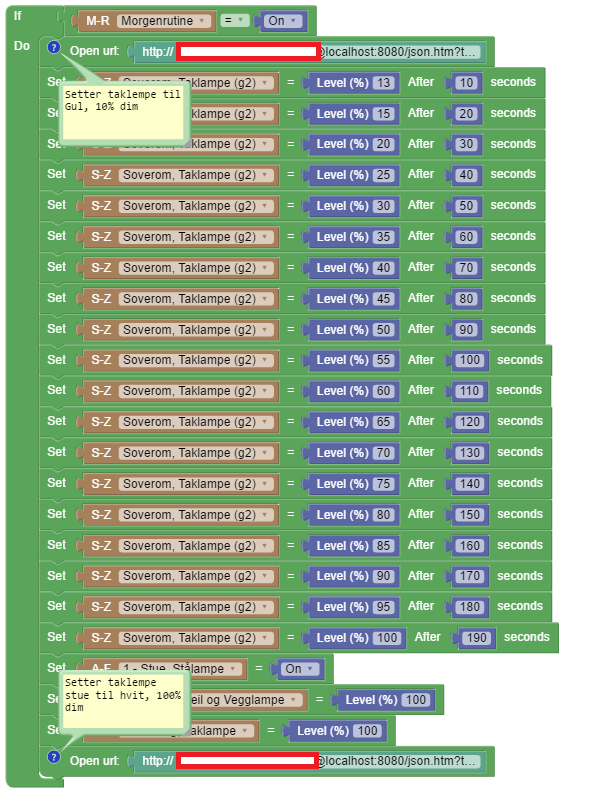

I use this, works perfect.
first json sets the light to "yellow" and dim 10%
Uten navn.png (134.76 KiB) Viewed 2118 times

How do you activate "Morgenrutine"? Alarmclock, fixed time or what?
