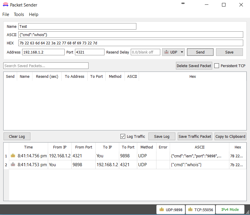

Hi dcliff1,
Try this in Windows,
Install Packet Sender https://packetsender.com/
Enter packet settings as:
ASCII: {"cmd":"whois"}
Address: IP Address of your gateway
Port: 4321
UDP
Click Send and see if you get an "iam" response from the gateway
corbin

Hey Corbin.
Great utility, i've not seen it before. I've used it and am getting the same response as you.
I tried resetting the gateway and cycling the password but same result.

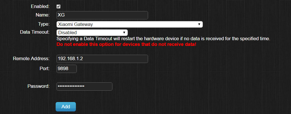

Here is my config.
Thanks mate!
