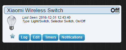

corbin wrote:Switches now have the extra options:
Just updated from git,
the wireless switch now identifies as Selector, after adding as switch, no way to edit and it recieved only "off" commands.
Any ideas?
EDIT: i have added it manually, and it works!!
the Long Press appears twice in logs (one for press and once for release i assume)
Last edited by levynger on Saturday 31 December 2016 12:01, edited 1 time in total.
