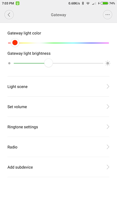

From Mi Home, can you go Gateway -> Device (from top menu) -> Gateway, then see options for Ringtone Settings and Radio?
ducseb
Posts: 8
Joined: Friday 23 December 2016 9:50
Post by ducseb »
Nope, no option to set Radio and Ringtone setting does not have MP3 uploading
corbin
Posts: 463
Location: Brisbane, Australia
Post by corbin »
Have you chosen Mainland China as your local?
Sorry, you said you have. But I think you have been very unlucky to receive a v1 gateway at this time - I ordered mine a few months ago and it is at least v2.
