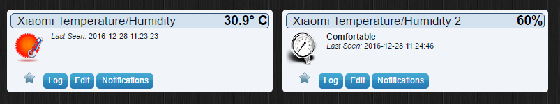

Would you prefer separate devices for humidity and temperature, or a combined device? I currently have the devices seperate -pavelbor wrote:Hello, i also have something to add, now in log-file i see my Xiaomi temp/hum sensors:

Cool, how it will look when you combine?Would you prefer separate devices for humidity and temperature, or a combined device? I currently have the devices seperate -

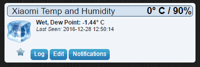

This is how it would look, however as the temperature and humidity are reported from the gateway in separate messages, I don't see a good way to combine them. It would be possible by querying the database, but I prefer to keep things simple.
ERRORR2
- Posts: 10
- Joined: Tuesday 20 December 2016 5:52
- Target OS: Windows
Separate looks good!corbin wrote: Would you prefer separate devices for humidity and temperature, or a combined device? I currently have the devices seperate -

I've updated my pull request with temperature and humidity sensors handled.ERRORR2 wrote:Separate looks good!corbin wrote: Would you prefer separate devices for humidity and temperature, or a combined device? I currently have the devices seperate -

Compiled new version. Now I can control socket and see temperature sensor! Great work! But can't see humidity.corbin wrote: I've updated my pull request with temperature and humidity sensors handled.

Thanks! After some time I can see humidity sensor too.tiboo86 wrote:ERROR2, Wait a few minutes, they go up again.

I have both splitted and combined Xiaomi temp/hum sensors listed in devices:
And good news: looks like battery level is present (100), but only in splitted Temp device.
93 Gateway 804D 77 Xiaomi Temperature Temp LaCrosse TX3 21.7 C - 100
97 Gateway 804D 1 Xiaomi Humidity Humidity LaCrosse TX3 Humidity 42 % - -
102 Gateway 804D 2 Xiaomi Temperature Temp + Humidity LaCrosse TX3 21.7 C, 43 % - -
