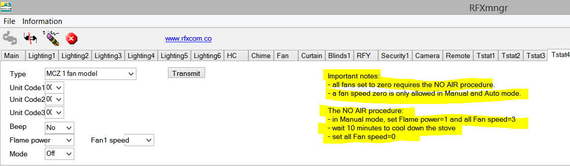

gizmocuz wrote:I think it is very dangerous to control it via domoticz.
In the RFXmngr there is a important note about the MCZ fan.

Hi Black64,
You are right , and it is an important to remind this point when we will write lua code. Nevertheless, as Timbiker said, the internal sensor in the stove is doing this check and regulate the temperature in case of remote damage. For exemple, when I turn off the stove, fans are still working during at least 15 minutes.
Anyway, I am available to check all this in a future beta version ;)
