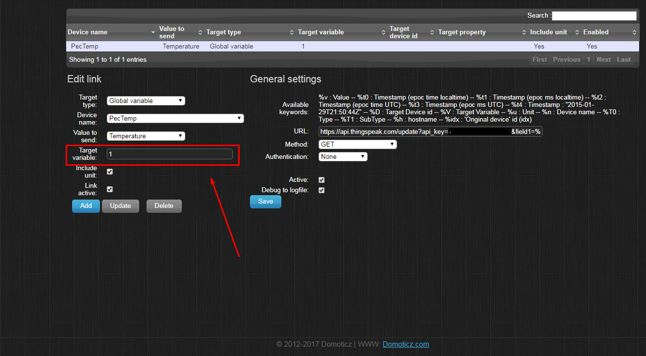

Re: HTTP Data Push not keeping url
This setings work for my:
The target variable is 1, 2 ,3 e.t.c.
