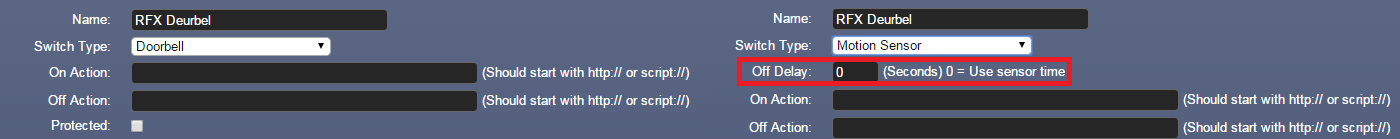

In this case I would like to achieveMavy wrote:What exactly are you trying to achieve? As said before the doorbell only send an on command, so you wont actually see anything change other then a new on record in the log.
If (dark) & (doorbell is pressed (status = chime) then "switch on front door light"
after 1 minute switch off the light.
I thought if status of the doorbell would reset to "off" after 1 minute this could help me to switch the front light off.
The reset option is available with the motion sensor.
- Doorbell vs Motion
- Domoticz_Doorbell.png (16.92 KiB) Viewed 2655 times
