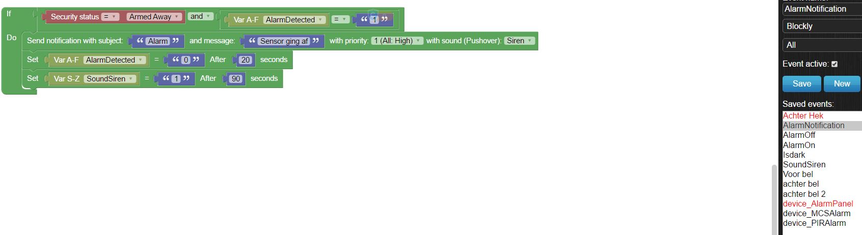

Not sure I understand. If motion is detected (MCS/PIR lua scripts -> AlarmDetected='On') and the alarm is armed (AlarmMelding Blocky) then SoundSiren is set to On after 90 seconds. This is to allow someone to enter the door and disarm in a regular way. If the system is not disarmed then the SoundSiren blocky will sound the alarm for 3 minutes (set Sirene = 'On' for 3 minutes).
So this was implemented using "on for xx minutes". I am probably missing your point. Feel free to pm me.

Hello, I have a question I used the alarm wiki
but the var. Sound Siren is no 1 so I can not send me siren ?? Who wants to help me

Hi Benotje,
As per one of my previous posts, domoticz no longer triggers of variable changes, It used to do that but that stopped working at some point. Replace your variables with dummy switches and test these on change.
