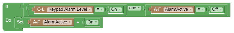

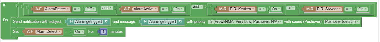

Yes. What I have done is I have created a blocky that sounds the alarm based on a variable SoundSiren'"1" and SecurityStatus="Armed Away". The lua scripts trigger the variable AlarmDetected so I can act on any alarm raised. A blocky event then acts based on this and sets SoundSiren to "1" after 90 seconds. That way, the alarm will only go off after 90 seconds and I have time to shut it down.
The only other thing I did was create 2 additional blocky's AlarmOn and AlarmOff where the first sets a variable AlarmActive when the Alarm status is "Armed Away" and the second (AlarmOff) resets all te variables so nothing gets triggered. I needed the AlarmActive because, otherwise, the scripts would get triggered constantly (since events are time based afaik ie not triggered by a device/variable state change).
I hope to release the total wiki shortly (as soon as I have time to create the page). that will include the blocky's and all.

im busy with your alarm system which is described at the wiki
All motionsensors named PIR_naamx
the zipato keypad is named Keypad Alarm Level
made the variables and blocky's.
The keypad changes states from on to off and visaversa.
When I trigger a PIR_ sensor trigger, I see that in the log
quote:
2015-12-22 22:36:24.311 OpenZWave: Alarm Level: Tamper
2015-12-22 22:36:24.321 LUA: AlarmPanel Arm Away
2015-12-22 22:36:24.312 (Zwaveusb) Lighting 2 (Keypad Alarm Level)
2015-12-22 22:36:24.367 (Zwaveusb) Lighting 2 (Unknown)
2015-12-22 22:36:46.998 (Zwaveusb) Lighting 2 (PIR_SKvoor)
Nthing happens, not even a notification
any idea?

after the tip from heggink to change the user variables with dummyswitches, I took the same idea, but try to do it with blockly.
This is what I come up with atm.
Dummyswitches:
Set alarm:
Motiondetection
Set Siren:
SoundSiren:
Alarmoff:
after a short test it worked, but didnt test it with delays etc.
Also the switch SoundAlarm doesnt switch everytime when AlarmDetect is switched on.

My blokcly seems to work as a charm!
I made an extra check (IemandThuis), if that one is on, then turn off the virtual switches and siren (send off signal, even when its off).
Still I need to disarm with the keypad, to change the state to off.
It also seems that the fibaro Smokesensor isnt working that well, so I switched it for my Everspring Siren.
