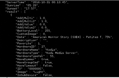

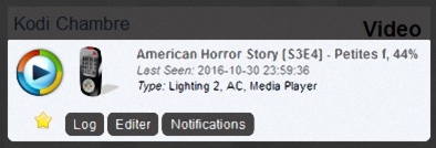

when I watch a TV show with a long title and a long episode name, the info displayed in the KMS sensor is incomplete:
Sans titre.jpg (46.04 KiB) Viewed 4709 times
In my terminal (Raspberry pi 2 wheezy), the info is incomplete too when i run
curl -s "http://IP:Port/json.htm?types=devics&rid=IDX
Sans titr3.jpg (61.31 KiB) Viewed 4709 times
But everything is displayed correctly in the log:
Sans titr2.jpg (33.36 KiB) Viewed 4709 times
So, Is threre a way to obtain the entire info in the KMS sensor ? I really need this for my Text To Speech project.

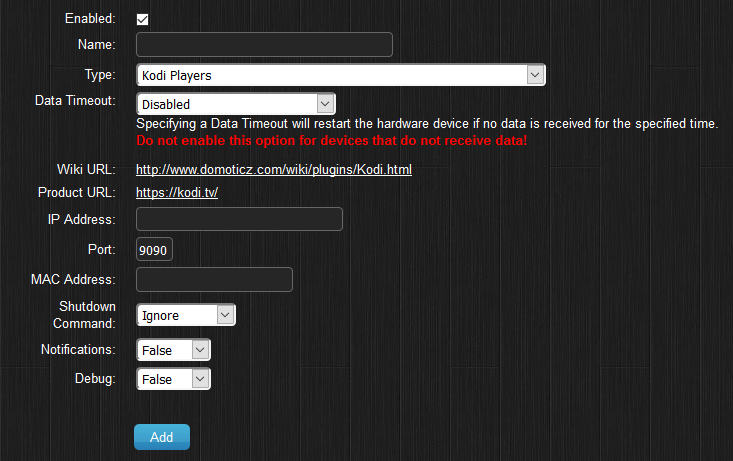

2. Extract Kodi.py and place it in the 'plugins' directory. It is directly under the 'domoticz' directory
3. Stop and restart Domoticz, check the log for any errors. If there are none then it's good to go :!:
4. In a web browser go the Hardware page, in the 'Type' dropdown there should now be a type called 'Kodi Players'. Select it.
Kodi 1.png (90.74 KiB) Viewed 4202 times
5. The plugin will attach to a single Kodi (create multiple instances if you have more than one)
6. Enter a name. This will be used as the base for the initial device names so make it meaningful.
7. Enter the IP Address. If it's hardware that can be started using wake-on-LAN then enter a MAC address otherwise leave blank
8. Set what you want the shutdown command to do from the dropdown.
9. Press 'Add' and it should be added to the table at the top of the page.

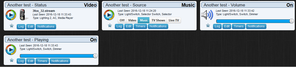

10. Four new devices will have appeared in the 'Devices' & 'Switches' page.
11. Stop and Start Domoticz again otherwise updates don't show up in the web pages (I need to work out why this is required but currently it is.)
12. You are done :!:
Kodi 2.png (72.93 KiB) Viewed 4202 times
The four devices are:
Status - pretty much the same as the old Kodi plugin. Clicking the icon turns the device off & on. Remote doesn't work yet.
Source - Shows what media type is. Clicking on the buttons will jump the Kodi to that media type.
Volume - Mute/Unmute when clicking on icon. Slider shows & sets volume
Playing - Play/Pause when clicking on the icon. Slider will jump playing media to that position
You can rename, delete or hide devices you don't want (the plugin won't care), you can change the button text on the source as well (but not the numbers).
Seems to work pretty well but there are still a couple of bugs as the screen shot shows. Stream internet radio confuses the Status & Source, just report these and I'll see what I can do. There is a debug setting on the hardware page that will dump details in the log that I will need to look into bugs.

Re: Kodi Mediaserver Support
Post by jake »
Too bad, after step 3, I still found the python error on the domoticz log, I may have overlooked it the other night:
"PluginSystem: Failed dynamic library load, Python not found on your system"
Therefore the 'kodi player' as stated in step 4 is not found either.
I followed your earlier instructions by installing python 3 with apt-get, although it turned out to be a 3.2.3 version. Is there anything I can do to influence it to install a higher version?
