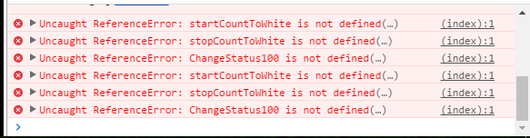

@SwordFish it looks like javascript functions are not executed, on a pc check the network on your browsers developer tools.
Use the slider and check if it generates traffic
I checked the consol when i used the slider. I give me a error.
Index:1 is the doctype of the index.html
racquemis
Posts: 73
Joined: Monday 02 November 2015 18:12
Post by racquemis »
Looks like you copied the first part of the code in my instructions but not the second which includes all the functions.

racquemis wrote:Looks like you copied the first part of the code in my instructions but not the second which includes all the functions.
I had placed the function code right under need the dimmer code. Now i moved it under the switch dimmer and it works.
Thanks for the help.
