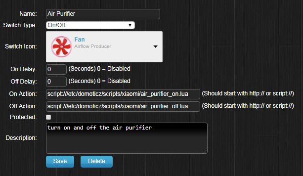

I`m also facing issues with this. My switch triggers two scripts, on and off. It throws the error 256 on both on and off action, however the on does get executed and turns on the purifier. I can`t understand why, since the scripts look exactly the same, both are owned by root and permission 777 had been applied.
ON:
#!/usr/bin/lua
if (devicechanged['Air Purifier'] == 'On') then
    os.execute ('node /etc/domoticz/scripts/xiaomi/airpurifier.js 192.168.1.20 power true > /dev/null')
return commandArray
OFF:
#!/usr/bin/lua
if (devicechanged['Air Purifier'] == 'Off') then
    os.execute ('node /etc/domoticz/scripts/xiaomi/airpurifier.js 192.168.1.20 power false')
return commandArray
root@stf-pi:/etc/domoticz/scripts/xiaomi# pwd
root@stf-pi:/etc/domoticz/scripts/xiaomi# ls
airpurifier.js  air_purifier_off.lua  air_purifier_on.lua
2017-07-29 19:36:22.376 Error: Error executing script command (/etc/domoticz/scripts/xiaomi/air_purifier_on.lua). returned: 256
2017-07-29 19:36:32.979 Error: Error executing script command (/etc/domoticz/scripts/xiaomi/air_purifier_off.lua). returned: 256
2017-07-29 19:39:17.320 Error: Error executing script command (/etc/domoticz/scripts/xiaomi/air_purifier_on.lua). returned: 256
2017-07-29 19:39:27.036 Error: Error executing script command (/etc/domoticz/scripts/xiaomi/air_purifier_off.lua). returned: 256
2017-07-29 19:41:07.420 Error: Error executing script command (/etc/domoticz/scripts/xiaomi/air_purifier_on.lua). returned: 256
2017-07-29 19:41:15.853 Error: Error executing script command (/etc/domoticz/scripts/xiaomi/air_purifier_off.lua). returned: 256
Can somebody help pls?

The answer is above in this thread. You need an "intermediate" script which launches your lua sript with an "&" at the end of the command line to return to Domoticz without waiting. See my post of Sept 16 2015 and the post from jpinzon408 dated 21 Oct 2016.
Rgds,

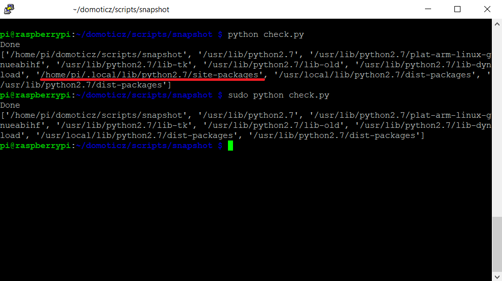

When one of this problem hit me, was it because my python library environment path not was set when run from root/sudo
domoticz run python scripts with sudo/root environment path's
Stop Domoticz service:
sudo /etc/init.d/domoticz.sh stop
Run Domoticz direct from terminal:
./home/pi/domoticz/domoticz
Run the script from inside domoticz (pushbutton etc..)
now you shuld see in terminal what cuase the problem
you can run this python code to check your environment path's the user using
import sys
print (sys.path)
for me sudoers missing /home/pi/.local/lib/python2.7/site-packages
to fix that you can add this directly in your python code
import sys
sys.path.append('/home/pi/.local/lib/python2.7/site-packages')

old thread but...
timmpo, thanks for sharing your solution, it saved my day! (after all other fixes about rights, wrapping the python script in a bash shell etc failed).
My newly installed and imported lib was just not in the path...

@timmpo: many thanks! Your solution about an incomplete PATH variable saved my weekend!
Especially the suggestion about running Domoticz from the terminal and then printing sys.path was extremely clarifying.
Thanks again!

A good check before doing anything is to run the script with sudo beforehand. It should give an idea where the problems are.
I found that with my python scripts, I needed to install a library again using sudo pip install <libraryname> - saves having to edit the path.
