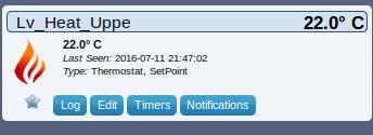

Hi i have a Remotec ZXT-120.
I can set the value:
textDevIdx = 243
modeCmd = '22'
commandArray['OpenURL'] = 'http://127.0.0.1:8080/json.htm?type=com ... evice&idx=' .. textDevIdx .. '&nvalue=0&svalue=' .. modeCmd
My problem is that i dont know how to get the actual set value from Remotec ZXT-120.
I can read the value on the screen but i cant get the value i LUA.
Screenshot from 2016-07-12.jpg (8.66 KiB) Viewed 8230 times
Can someone help me.

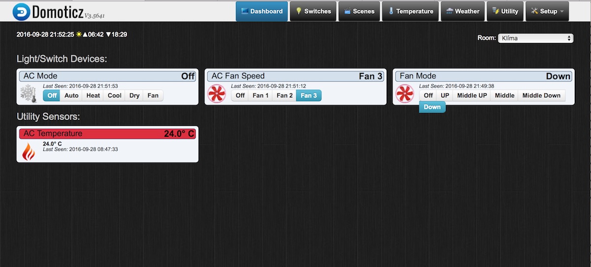

madrian
Posts: 231
Re: Domoticz - air conditioning control
Post by madrian »
Here is my solution, based on Toni's code.
Mine case is different, because I am using Esp Easy firmware on my Wemos D1 with Heatpump plugin + an Ir transmitter.
-- These are the configuration variables, set them according to your system
modelCmd = 'fuego'
for key, value in pairs(devicechanged) do
  if (key == 'AC Mode' or key == 'AC Fan Speed' or key == 'AC Temperature' or key == 'Fan Mode') then
    mode = otherdevices['AC Mode']
    fanSpeed = otherdevices['AC Fan Speed']
    fanMode = otherdevices['Fan Mode']
    temperature = math.floor(otherdevices_svalues['AC Temperature'])
    if     (mode == 'Off')   then powerModeCmd = '0' heatModeCmd = '1'
    elseif (mode == 'Auto')  then powerModeCmd = '1' heatModeCmd = '1'
    elseif (mode == 'Heat')  then powerModeCmd = '1' heatModeCmd = '2'
    elseif (mode == 'Cool')  then powerModeCmd = '1' heatModeCmd = '3'
    elseif (mode == 'Dry')   then powerModeCmd = '1' heatModeCmd = '4'
    elseif (mode == 'Fan')   then powerModeCmd = '1' heatModeCmd = '5'
    if     (fanSpeed == 'Auto')  then fanSpeedCmd = '0'
    elseif (fanSpeed == 'Fan 1') then fanSpeedCmd = '1'
    elseif (fanSpeed == 'Fan 2') then fanSpeedCmd = '2'
    elseif (fanSpeed == 'Fan 3') then fanSpeedCmd = '3'
    if     (fanMode == 'Off')  then fanModeCmd = '1'
    elseif (fanMode == 'UP') then fanModeCmd = '2'
    elseif (fanMode == 'Middle UP') then fanModeCmd = '3'
    elseif (fanMode == 'Middle') then fanModeCmd = '4'
    elseif (fanMode == 'Middle Down') then fanModeCmd = '5'
    elseif (fanMode == 'Down') then fanModeCmd = '6'
    temperatureCmd = temperature
    modeCmd = modelCmd .. ',' .. powerModeCmd .. ',' .. heatModeCmd .. ',' .. fanSpeedCmd .. ',' .. temperatureCmd .. ',' .. fanModeCmd
    print(string.format('Mode: %s, fan: %s, temp: %s, modeCmd: %s', mode, fanSpeed, temperature, modeCmd))
    commandArray['OpenURL'] = 'http://192.168.1.7/control?cmd=heatpumpir,' .. modeCmd
return commandArray

Now, when I change one of the selectors or the temperature setpoint the log shows:
2016-10-31 12:56:44.055 LUA: Mode: Cool, fan: Fan 4, temp: 18, modeCmd: 00013412
2016-10-31 12:56:44.055 Error: EventSystem: in heatpumpir: [string "-- These are the configuration variables, set..."]:40: attempt to concatenate field '?' (a nil value)
2016-10-31 12:56:44.042 (Heatpump) Thermostat (Heatpump Temperature)
and every minute I get this error:
2016-10-31 12:57:00.114 Error: EventSystem: in heatpumpir: [string "-- These are the configuration variables, set..."]:10: bad argument #1 to 'pairs' (table expected, got nil)
So - my question is - what should I do to fix the "table expected, got nil" error?
And - will that also fix the "attempt to concatenate field '?' (a nil value)" error?
|| UPDATE || .. a reboot fixed the concatenate error...
new log looks like this (and the node receives and sends commands...)
 2016-10-31 14:39:07.605 User: Admin initiated a switch command (5/Heatpump Mode/Set Level)
2016-10-31 14:39:07.633 LUA: Mode: Auto, fan: Fan 5, temp: 22, modeCmd: 00111516
2016-10-31 14:39:07.641 EventSystem: Script event triggered: heatpumpir
2016-10-31 14:39:07.607 (Heatpump) Light/Switch (Heatpump Mode)
2016-10-31 14:39:07.768 (MySensors) Lighting 2 (IR send)
2016-10-31 14:39:08.373 (MySensors) Lighting 2 (IR send)
2016-10-31 14:40:00.683 Error: EventSystem: in heatpumpir: [string "-- These are the configuration variables, set..."]:10: bad argument #1 to 'pairs' (table expected, got nil)

Maybe you have found the solution, but could be useful for other user:
In the line: commandArray['UpdateDevice'] = otherdevices_idx[textDev] .. '|0|' .. modeCmd
change for: commandArray[otherdevices_idx[textDev]] = {['UpdateDevice'] = otherdevices_idx[textDev] .. '|0|' .. modeCmd }

logger02 wrote:Maybe you have found the solution, but could be useful for other user:
Thank you for the the pointer... unfortunately it still produces the same error:
 2016-11-14 09:28:58.853 User: Admin initiated a switch command (5/Heatpump Mode/Set Level)
2016-11-14 09:28:58.875 LUA: Mode: Cool, fan: Fan 3, temp: 18, modeCmd: 00013312
2016-11-14 09:28:58.882 EventSystem: Script event triggered: heatpumpir
2016-11-14 09:28:58.855 (Heatpump) Light/Switch (Heatpump Mode)
2016-11-14 09:29:00.484 Error: EventSystem: in heatpumpir: [string "-- These are the configuration variables, set..."]:10: bad argument #1 to 'pairs' (table expected, got nil)
2016-11-14 09:30:00.018 Error: EventSystem: in heatpumpir: [string "-- These are the configuration variables, set..."]:10: bad argument #1 to 'pairs' (table expected, got nil)
The script seems to be doing what it should, but do I have to create a table manually somewhere to get rid of the error messages that appears every minute?
BTW, the script is copy/pasted from Toni's post: viewtopic.php?f=34&t=7179&p=104083#p74624 , now with the change proposed by logger02

Try my script. I use your script with a little modification:

Looks like I'm gonna have to create a couple more Dumme devs to use your script.
What's the purpose of "AC_Model"?
Anyway, my script looks like this:

--UPDATE--
Tried adding the fanmode dummy dev, and enabling your script - modding it to look for my devices.
Still get the error message though (new line line number, but same issue):
