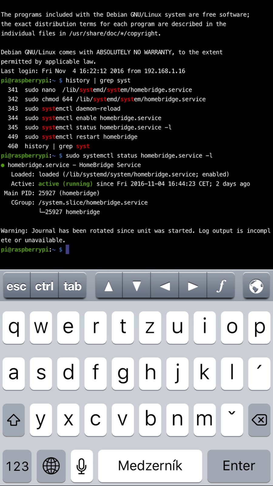

More iOs 10 problem:
iPhone 7/iOS 10 after some time Home app doesn't see the Homebridge. It keeps saying for all devices: Updating. In same time I checked with my iPhone 5S/Eve app: works fine.
Homebridge status is OK:
...after restarting Homebridge, iOS10 works again. Interesting.
