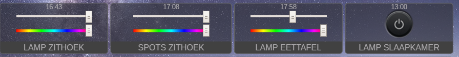

Something like this? I made this for my milight RGBW lights. Sliders can only be controlled from a touch device by pressing the position you want it to go. Sliding doesn't seem to work. But colors can still be selected pretty accurate. This also corrects for the shift in hueTeunissm wrote:Hello,
I am modifying G3rard's frontpage by experimenting and searching on this forum and piece by piece i'm getting closer to the frontpage I like. I'm only wondering: is there somehow a possibility to ad RGB switches in this frontend? When i add such a switch as a "level" device I can control the light bij switching it on and of and dimming the light. But i also want to change the colors. Is that possible to create?
Marcel
Still have to find an accurate way to switch back to white. I'll share the code when done.

HMTL Slider controls for RGBW lights (Mi-Light + Others)
I added a HTML5 slider control that allows you change brightness and hue.
Sliding the bar does not work correctly on touch devices, however by tapping the control at the desired position you can control your lights brightness and hue just fine.
Code has been tested on a 10 inch Tablet (Toshiba Encore 2 WT-10) on the chrome browser on a tweaked frontpage.
I give this code as-is, i can't garantuee that it will give you the same accuracy in color selection as i experience
Tweak the code yourself if you run into any problems. if the controls don't stay within their cell, tweak the inline css.
Brightness
Brightness can be controlled with a 1% interval in the range 0-100%
Hue
Hue can be controlled with a interval of 1 degree in the range 0-360
Milight has an offset in the hue of around 24. To correct for this set the plusmin parameter of your device to 100 in the FrontPage settings
Use 101 for other brands of lights if they don't exhibit the same problem
Return to white
To return your lights to white, press and hold on the brightness slider for two seconds.
Installation
In frontpage.js locate the dimmer if statement, search for
Replace the entire if statement with the one below:
Next, locate the line
And add the following line above it
Next Add the following functions to the frontpage.js file, i added them below the SwitchDimmer function but the location does not matter as long as it's in the script.
Visuals on Chrome Browser
Visuals on Edge Browser
In frontpage_settings.js locate your RGBW control entry and change the plusmin parameter to 100 for milight or 101 for other lights e.g.
If you can't get it to work, backup yout frontpage.js file and replace it with the one i've attached to this post

<!-- Main Frontpage fuction -->Code: Select all
var hue_array = [];Code: Select all
//Color Picker
function ChangeHue(hue,brightness,idx,offset){
var newhue = parseInt(hue) + offset;
['98','Level', 'cell10', 'Lamp Zithoek','1','100'] - Attachments

@racquemis,
I have added the code just as you said but in my frontpage the milight wich i see as dimmer when is use "vplusmin 1" in the settingstab dissapear when i change the "vplusmin" to 100 or 101?
Do you have any idea?
Marcel
Marcel
racquemis
- Posts: 73
- Joined: Monday 02 November 2015 18:12
I've edited the post with the instructions to make it more foolproof, also i forget to add one line of code.
See if you can get it working now, if not use my frontpage.js i have attached to that post.

Indeed, the missing code was the problem. Got it working now and it works perfect.
Thanks for this piece of work.
Marcel

Awesome racquemis, works like a charm on my milight bulb and strips.

Only for the milight controller? Or is this working for milight through rflink also? Would be nice!
Confirmed: working with rflink too!

If if the device type is dimmer and you can control rgb values from domoticz it should work.
