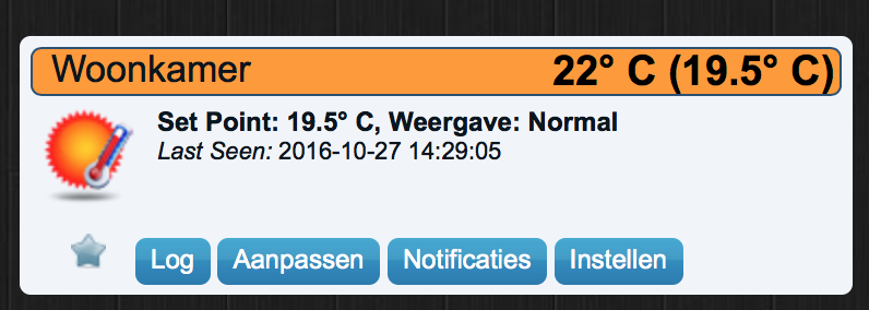

Is it possible to create a dummy thermostat just like the evohome system has, with a thermostat setpoint and the actual temperature. now is it only possible to create a dumme thermostat setpoint.
i've tryed it to create a virtual thermostat using this url
/json.htm?type=createvirtualsensor&idx=894&sensorname=Testthermostaat&sensortype=70
(in the database the evohome devices has type 70)
Schermafbeelding 2016-10-27 om 14.30.00.png (78.96 KiB) Viewed 10287 times

found out that the url was wrong... correct url is :
/json.htm?type=createevohomesensor&idx=<IDX OF DUMMY HARDWARE>&sensortype=70
maybe it can be implemented in de dummy hardware list?
