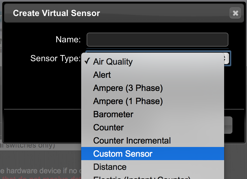

So question on the dummy sensors, I have created a dummer sensor in the hardware but when I go to devices which sensor type do I select? counter? I have tried this and it appears to be kw/h
Would it be text then?
safi78
Posts: 204
Joined: Thursday 05 September 2013 15:39
Domoticz version: LastBeta
Re: monitor internet connection with virtual sensors
Post by safi78 »
You create a 'Virtual Sensor' of the Sensor Type 'Custom Sensor'.
Screen Shot 2016-11-02 at 17.20.52.png (138.14 KiB) Viewed 4997 times
