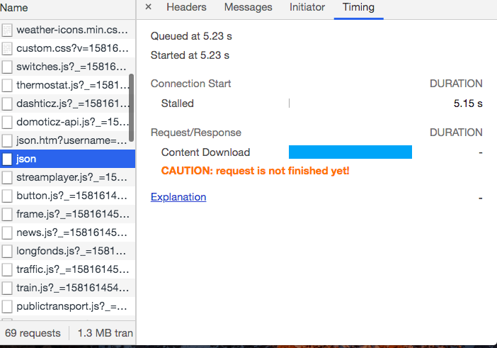

Dashticz became laggy and threw errors.. 'dashticz became unresponsive'.. and then ask to wait or cancel the operation. Thinking this was due to the fact that my DiskStation was using too many processes, I decided to move the webserver part to a RPi. After working with the default settings, I then put back the config and it worked... for a moment, then the same error about unresponsive returned.
I tried to get more info fro the developers tool on Chrome.
Screen Shot 2020-02-13 at 18.30.46.png (106.28 KiB) Viewed 1368 times
Lokonli
Posts: 2292
Re: Unresponsive
Post by Lokonli »
That is the websocket connection. The websocket connection will stay open, and should be no problem.
Can you test with adding to CONFIG.js the following:
config['enable_websocket'] = 0
This will disable the websocket connection.

When I remove the multigraph then everything works again.

EdwinK wrote: Saturday 15 February 2020 11:39 This is what I have (from the readthedocs instrcutions)

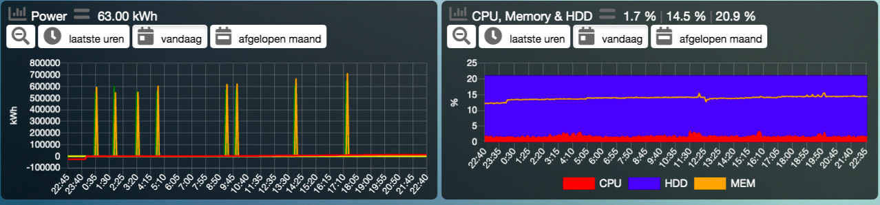

Now this gives a error in config.js. Time to do some troubleshooting.
EdwinK
Posts: 1820
Location: Rhoon
Re: Unresponsive
Post by EdwinK »
This one works
blocks['multigraph_17'] = {
        title: 'CPU, Memory & HDD',
        devices: [ 491, 493, 495 ],
        datasetColors: ['Red', 'Orange', 'Blue', 'Green', 'LightBlue', 'Aqua', 'Yellow', 'Purple', 'Pink'],
        legend: true,
        cartesian : 'linear',
        graph: 'line',
        lineFill: true,
        drawOrderDay:   ['v_491', 'v_495', 'v_493'],
        drawOrderMonth: ['v_min_17', 'v_avg_17', 'v_min_18', 'v_max_17', 'v_avg_189', 'v_max_189', 'v_min_189', 'v_avg_18', 'v_max_18'],
        legend: {
                'v_491'          : 'CPU',
                'v_avg_491'       : 'CPU avg',
                'v_max_491'      : 'CPU max',
                'v_min_491'      : 'CPU min',
                'v_493'          : 'MEM',
                'v_avg_493'      : 'MEM avg',
                'v_max_493'      : 'MEM max',
                'v_min_493'      : 'MEM min',
                'v_495'         : 'HDD',
                'v_avg_495'     : 'HDD avg',
                'v_max_495'     : 'HDD max',
                'v_min_495'     : 'HDD min'
This one as well:
blocks['graph_1'] = {
    title: 'My Power',
    graph: ['line','bar','bar'],
    custom : {
        "last day": {
            range: 'day',
            filter: '24 hours',
            data: {
                nett: 'd.v+d.v2-d.r1-d.r2',
                usage: 'd.v+d.v2',
                generation: '-d.r1-d.r2'
        "last 2 weeks": {
            range: 'month',
            filter: '14 days',
            data: {
                usage: 'd.v+d.v2',
        "last 6 months": {
            range: 'year',
            filter: '6 months',
            data: {
                usage: 'd.v+d.v2',
    legend: true,
    datasetColors:['blue','red','yellow']
Working, sort of..
Working, sort of..
Screen Shot 2020-02-16 at 22.46.51.png (334.19 KiB) Viewed 1165 times

For latest betas there are some changes:
I suppose your device idx for your graph is 1.
You have to define your device and use the _idx fot the graph types in the custom section.
    title: 'My Power',
    devices: [1],
    custom : {
        "last day": {
            range: 'day',
            filter: '24 hours',
            data: {
                nett: 'd.v_1+d.v2_1-d.r1_1-d.r2_1',
                usage: 'd.v_1+d.v2_1',
                generation: '-d.r1_1-d.r2_1'
        "last 2 weeks": {
            range: 'month',
            filter: '14 days',
            data: {
        "last 6 months": {
            range: 'year',
            filter: '6 months',
            data: {
    legend: true,
Blah blah blah
