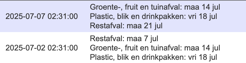

latest version running,
how do I get this icon ?
I added the , icon = 'xxx' part according the example and checked that http://127.0.0.1:8080 is reachable but no icon (yet)
['Groente-, fruit, etensresten en klein tuinafval'] ={hour=16,min=22,daysbefore=1,reminder=0,text='Groente-, fruit en tuinafval', icon = 'garbagecalendar_green'},
['Restafval'] ={hour=16,min=22,daysbefore=1,reminder=0,text='Restafval', icon = 'garbagecalendar_grey'},
['Papier en karton'] ={hour=16,min=22,daysbefore=1,reminder=0,text='Papier en karton', icon = 'garbagecalendar_blue'},
['Plastic, blik en drinkpakken'] ={hour=16,min=22,daysbefore=1,reminder=0,text='Plastic, blik en drinkpakken', icon = 'garbagecalendar_orange'},
['Textiel'] ={hour=16,min=22,daysbefore=1,reminder=0,text='Textiel'},
['Kerstbomen'] ={hour=16,min=22,daysbefore=1,reminder=0,text='Kerstbomen'},
RPI4 Beta / Tasmota / ZigBee2MQTT / P1meter / Haier AC MQTTmapper / SolarEdge SE3500H modbus_tcp / Marstek Venus / Opentherm gateway / Plugwise Anna/Smile / ObserverIP weatherstation thru WuDirect
Feeding ADSB https://adsb.im/home
- jvdz
- Posts: 2476
- Domoticz version: 4.107
Re: GarbageCalendar (new version) lua scripts
Ah...you got it working...nice.
Could it be that there was no update for the text device since you added the icon bit?

Hi, today my "restafval" container was emptied ...
around 02:30 it fetched the next container and the container for today is not visible anymore ...
In an older version that switch took place the next night so on the current day it stayed visible.

I think i found the issue as I was able to test myself.
Update pushed to github for opzet_api not showing today's garbage.
Let me know if that fixes it for you.
