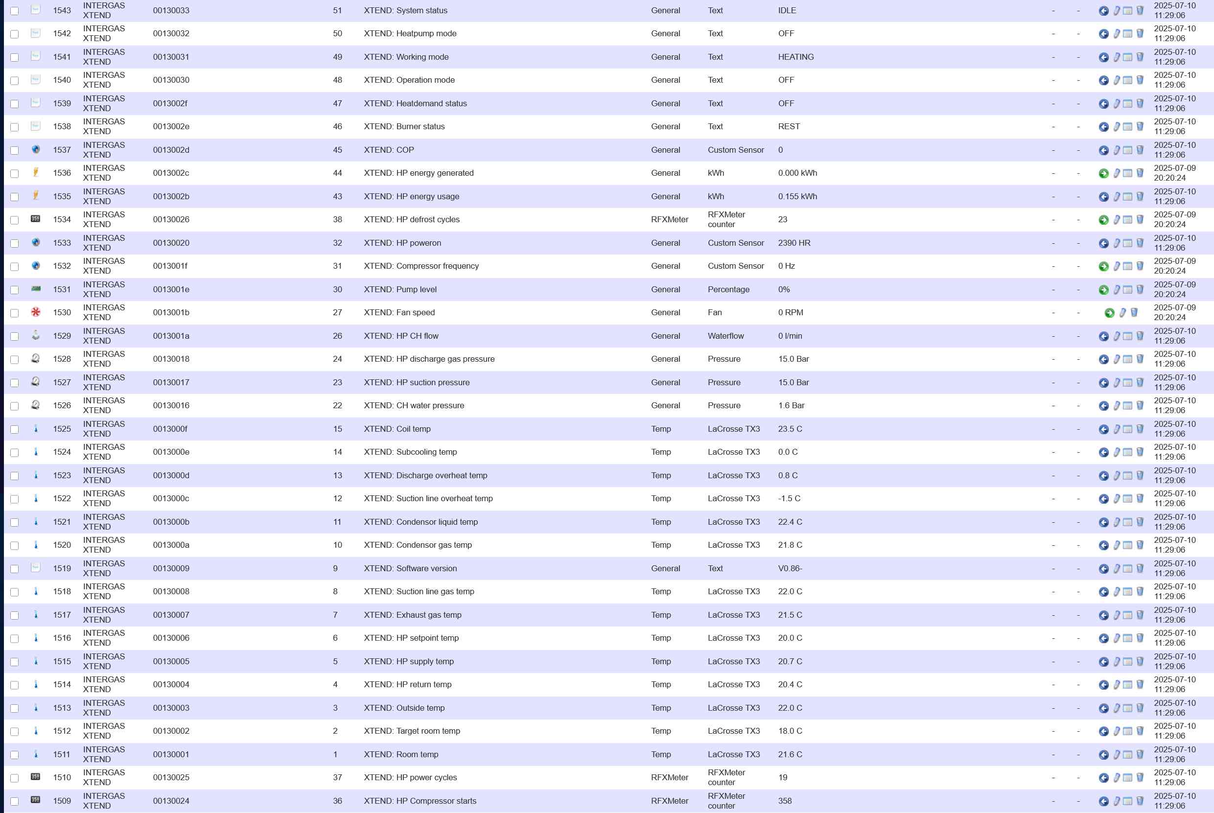

I don't know if it's related to this problem. The only devices with RFXMeter do show up in utility, but the Lacrosse TX3 and Depressure and the rest don't show up in temperature or switches.

In menu Setup - Users do you have devices assigned to the user (admin?) you are logging into Domoticz? If admin then remove all those shared devices. See also the Note on this subject in the wiki:teo1966 wrote: Thursday 10 July 2025 11:36 I don't know if it's related to this problem. The only devices with RFXMeter do show up in utility, but the Lacrosse TX3 and Depressure and the rest don't show up in temperature or switches.
https://wiki.domoticz.com/User_Management#Set_Devices
Note: It is advised not to set selected devices for an admin user as the rest of the devices will become invisible.
