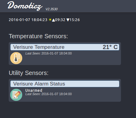

Here is my Lua script_time_verisure.lua:
And here screenshot from Domoticz.
Alarm status is Text device and Temperature is Temperature...
print('Verisure Status Update')
reply = os.execute ("curl --data '{\"get_temperature\"}' http://<YOUR_IP:50001>/&")
reply = os.execute ("curl --data '{\"get_alarm\"}' http://<YOUR_IP:50001/&")
return commandArray
- Verisure.png (34.7 KiB) Viewed 12190 times

Run the script, It'll push the updates straight into Domoticz. I have no smartplugs, so I haven't added any info for those yet.
