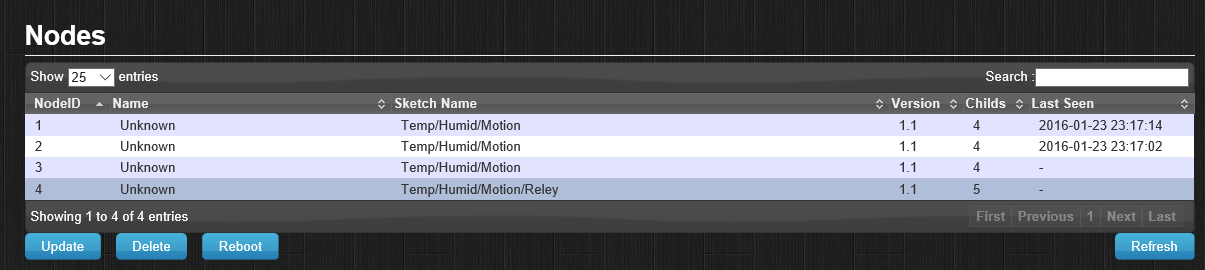

Sevift
- Posts: 31
- Joined: Monday 21 September 2015 16:02
- Domoticz version: Latest
Re: soft reboot node
Used by OTA firmware updates. Request for node to reboot.
I tried to implement it. I have not used even once git pull request (It would be nice to receive instructions)

I do not know C ++ and Java, and web. I do not know the architecture Domoticz. But it works. Strongly do not scold.
You have to have a bootloader with watchdogs enabled like optiboot or the MySensors bootloader

<div id="mysensors" style="display:none;">
<div class="page-header-small">
<table border="0" cellpadding="0" cellspacing="0" width="100%">
<tr>
<td>
<h1 data-i18n="Nodes">Nodes</h1>
</td>
</tr>
</table>
</div>
<table class="display" id="mysensorsnodestable" border="0" cellpadding="0" cellspacing="0" width="100%">
<thead>
<tr>
<th width="80" align="center" data-i18n="NodeID">NodeID</th>
<th align="left" data-i18n="Name">Name</th>
<th align="left" data-i18n="Sketch Name">Sketch Name</th>
<th width="60" align="left" data-i18n="Version">Version</th>
<th width="60" align="left" data-i18n="Childs">Childs</th>
<th width="160" align="left" data-i18n="Last Seen">Last Seen</th>
</tr>
</thead>
</table>
<table id="updelclr" border="0" cellpadding="0" cellspacing="0" width="100%">
<tr>
<td>
<a class="btnstyle3-dis" id="nodeupdate" data-i18n="Update">Update</a>
<a class="btnstyle3-dis" id="nodedelete" data-i18n="Delete">Delete</a> Code: Select all
<tr>
<td>
</td>
</tr>
</table>
</div>
<thead>
<tr>
</tr>
</thead>
</table>
<tr>
<td>
<a class="btnstyle3-dis" id="nodereboot" data-i18n="Reboot">Reboot</a>I do not know C ++ and Java, and web. I do not know the architecture Domoticz. But it works. Strongly do not scold.
