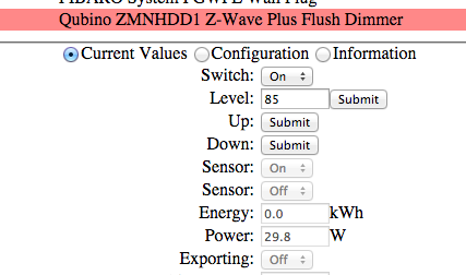

Re: Can't get I2 or I3 input work - Qubino dimmer ZMNHDD1
You should see a lot of 'switches' for this dimmer.
I don't use the inputs on that one, that's why they're just called 'alexSensor'
Wait.
When adding the switch to Group 5 in the ZWave network, I suddenly got a switch. This switch I added in Domoticz, and when I click on the button of the pulse switch, the switch turns ON and OFF. So I'm one step further: the switch is there, it work,s but doesn't behave like I want it to. I want it to be like: click once: turn switch ON. Click a second time: turn switch OFF. Etcetera.
How can I change this behavior ?
