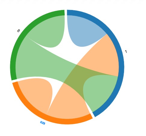

i currently use the aeonlabs gen5 stick(number 1)
fibaro 212 dimmer module(included last number 8)
Qubino flush2 relais module(included first number 7)
when i did the 212 inclusion the qubino module was also inside for testing
the fibaro modlue is 3 meters away
The qubino is 15 meters away and outside
i always thought z-wave modules would do a continuous discovery of their neighbors but it seems they do not
first picture is after pairing the 2 modules while both inside the house

first start point after including the modules

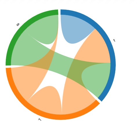

Well,
if you want something done right, you have to do it yourself
i moved module 7 back into the house and did a rediscover.
instantly i got the associations back.
now let's see if it keeps the assosiations if i movre it further away.
definately a distance issue
at least now al the other modules act as a relay
zwave-new after module 7 in house.jpg (42.28 KiB) Viewed 1503 times

Post by Gravityz »
yes it is however i tried this before and it seems that nothing was happening. also when i tried it with the modules which are close to the controller
i installed a fibaro plug in between, hoping for it to bridge the gap(which it did not)
after moving module 7 into the house it suddenly started to work on al the modules.
it seems that for association a mimimal signal level is required. after that it keeps the connections, also after moving module 7 out of the house again.
seems unlogical because i would have suspected that the controller would travel to the module closest to module 7 and from there on to module 7.
it can only do that if al the modules are aware of eachother(which they will do at a certain signal level)
