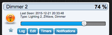

My domoticz interface shows now 74% what's the same as JSON.
Screen Shot 2015-12-21 at 20.35.21.png (27.04 KiB) Viewed 2127 times
   "CustomImage" : 0,
         "Data" : "Set Level: 74 %, Level: 74 %",

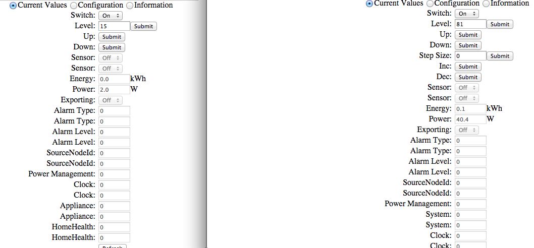

What I also notice is the dim speed. Module 1 is much faster than 2. I know this is a parameter but both are the same, both are 100. I've set dimmer 2 to 99 to check it takes the parameters but dimmer 1 is still faster than 2 in the dim speed. I've also found dimmer 1 has more parameters compared to dimmer 2.
(left dimmer 2, right dimmer 1) - whereas again dimmer 2 information like Level and Power are incorrect. (After a 'refresh node info' Level goes to 80, power to 27.9 watt)
Screen Shot 2015-12-22 at 08.58.00.png (96.81 KiB) Viewed 2098 times
There is also most of the times (at least as far as I can see) a 1% difference.
