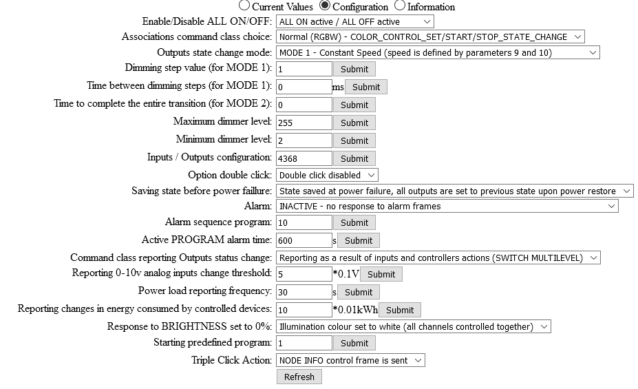

I'm using a Fibaro RGBW Controller in combination with an Aeon Z-stick Gen5, a Raspberry Pi 2B and a generic RGB Led-strip. I added the RGBW-node to Domoticz, and on the Switches screen the RGBW-device seems to work as expected most of the time. However, when I use a JSon URL to manipulate the color, something odd happens; the brightness level seems to jump to 100 before going to the set value. This sometimes happens when using the colorpicker as well. To illustrate: the URL below will first make the ledstrip bright yellow, before dimming down to the 40 level. Any thoughts?
json.htm?type=command&param=setcolbrightnessvalue&idx=XXXXX&hue=40&brightness=40&iswhite=false
(What seem to be) relevant parameters - others can be seen in the attached image:
1. Enable/Disable ALL ON/OFF
ALL ON Active / ALL OFF Active
6: Associations command class choice
Normal (RGBW) - COLOR_CONTROL_SET/START/STOP_STATE_CHANGE
