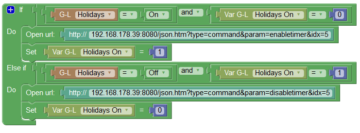

I am trying to do something completely different, but it does involve sending a json call through blockly. I tried the following:
Event with json.PNG (26.58 KiB) Viewed 1903 times
However when I activate this the configuration state is not changed even though my log tells me " fetching url...."
I read that Sincze solved the json in blockly so I am interested in how that is parsed to see what I am doing wrong.
