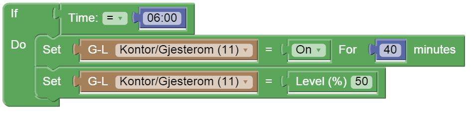

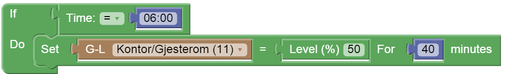

I don't have any dimmers, so I can't test, but try this;
og this:
idk if it will work
