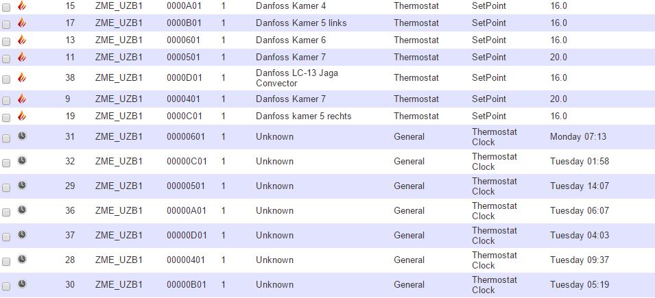

I use 24 Danfoss Thermostats
If I delete the Thermostat Clock it keeps coming back in the devices list.
Can this be made permanent and not keep coming back after a while.
I do not add or remove any nodes.
I do not use the Thermostat Clock I use json to set the correct temperature on event.
Here a snapshot from my devices.

Yep, they keep coming back. I already have 111 unused devices upon 100 used.
I am also wondering how to avoid that.
